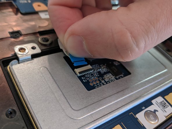

  7. ThinkPad 13 Chromebook Trackpad Replacement: crwdns2935265:07crwdnd2935265:01crwdnd2935265:02crwdne2935265:0 ThinkPad 13 Chromebook Trackpad Replacement: crwdns2935265:07crwdnd2935265:02crwdnd2935265:02crwdne2935265:0
    • Using the pointy end of a spudger or other tool, genty lift the cable lock.
    • Pull the blue tab of the trackpad ribbon cable to unplug the trackpad.
  8. ThinkPad 13 Chromebook Trackpad Replacement: crwdns2935265:08crwdnd2935265:01crwdnd2935265:01crwdne2935265:0
    • Lift the trackpad out of the case, bottom end first.
