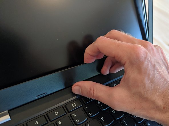

  7. ThinkPad 13 Chromebook Display Replacement, Display Removal: crwdns2935265:07crwdnd2935265:01crwdnd2935265:02crwdne2935265:0 ThinkPad 13 Chromebook Display Replacement, Display Removal: crwdns2935265:07crwdnd2935265:02crwdnd2935265:02crwdne2935265:0
    • Before proceeding, unplug and power down your ThinkPad. Set your computer to face you, with the screen open.
    • Use the plastic opening tool to pull the panel forward and release it from the display assembly.
    • You may need a little help from your fingers for the thicker bottom bezel.
    • Be careful not to put pressure on the LCD itself, as it could damage the display.

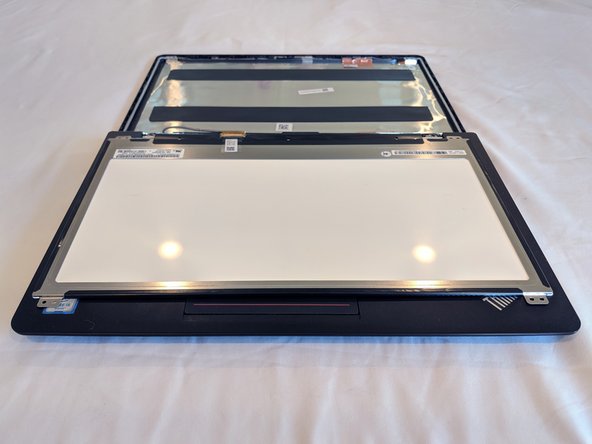

  8. ThinkPad 13 Chromebook Display Replacement: crwdns2935265:08crwdnd2935265:01crwdnd2935265:01crwdne2935265:0
    • Open the laptop completely to 180 degrees and lay it flat.
    • Remove the four screws that secure the LCD panel to the plastic. Do not confuse these for the screws securing the hinge to the display assembly.
  9. ThinkPad 13 Chromebook Display Replacement: crwdns2935265:09crwdnd2935265:01crwdnd2935265:02crwdne2935265:0 ThinkPad 13 Chromebook Display Replacement: crwdns2935265:09crwdnd2935265:02crwdnd2935265:02crwdne2935265:0
    • Carefully separate the LCD panel from the plastic cover. and lower the screen onto the keys.

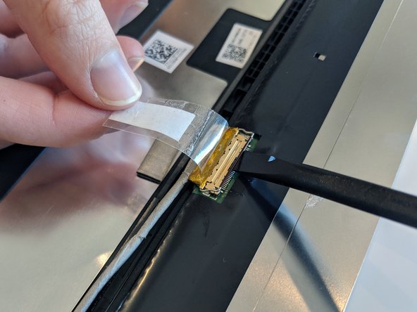

  10. ThinkPad 13 Chromebook Display Replacement: crwdns2935265:010crwdnd2935265:01crwdnd2935265:02crwdne2935265:0 ThinkPad 13 Chromebook Display Replacement: crwdns2935265:010crwdnd2935265:02crwdnd2935265:02crwdne2935265:0
    • Peel off the sticker securing the display cable to the LCD panel.
    • Using the flat end of a spudger, lift the cable lock and gently remove the display cable from the LCD panel.
    • Be very gentle removing this cable, as it is quite delicate.
