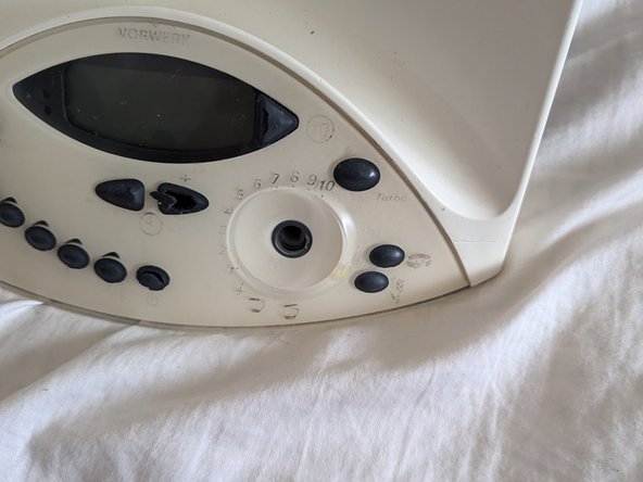

  1. Thermomix TM31 Control Panel Replacement, Remove Silicone Covers: crwdns2935265:01crwdnd2935265:01crwdnd2935265:02crwdne2935265:0 Thermomix TM31 Control Panel Replacement, Remove Silicone Covers: crwdns2935265:01crwdnd2935265:02crwdnd2935265:02crwdne2935265:0
    • Remove Contact Seal and Driving Pinion by pulling vertically or using Plastic Pry to lever out

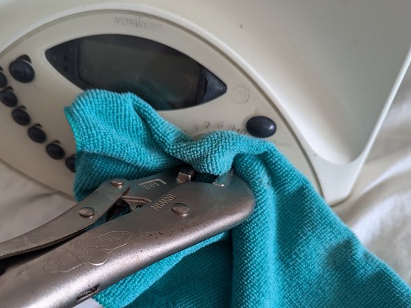

  2. Thermomix TM31 Control Panel Replacement, Remove Knob: crwdns2935265:02crwdnd2935265:01crwdnd2935265:03crwdne2935265:0 Thermomix TM31 Control Panel Replacement, Remove Knob: crwdns2935265:02crwdnd2935265:02crwdnd2935265:03crwdne2935265:0 Thermomix TM31 Control Panel Replacement, Remove Knob: crwdns2935265:02crwdnd2935265:03crwdnd2935265:03crwdne2935265:0
    • Use Cloth to protect knob from Scuffing and grab with Pliers. Pull straight out (this requires a bit of force)

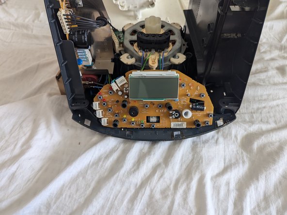

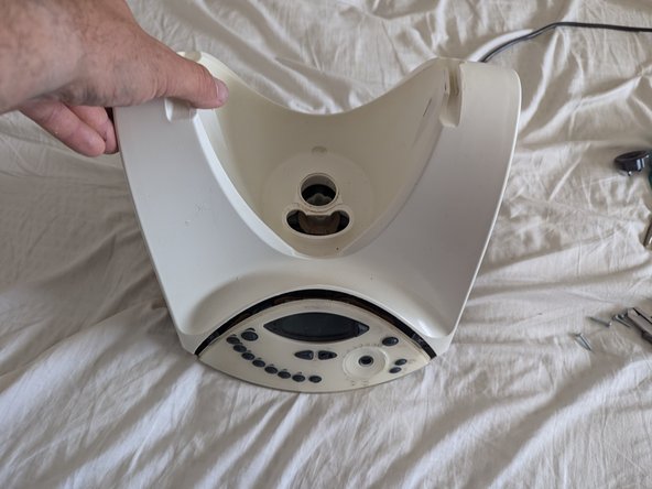

  3. Thermomix TM31 Control Panel Replacement, Remove white Plastic: crwdns2935265:03crwdnd2935265:01crwdnd2935265:03crwdne2935265:0 Thermomix TM31 Control Panel Replacement, Remove white Plastic: crwdns2935265:03crwdnd2935265:02crwdnd2935265:03crwdne2935265:0 Thermomix TM31 Control Panel Replacement, Remove white Plastic: crwdns2935265:03crwdnd2935265:03crwdnd2935265:03crwdne2935265:0
    • Remove the 7 marked T20 Screws. This will leave the White Plastic Cover loose.
    • Lift off the White Plastic Cover

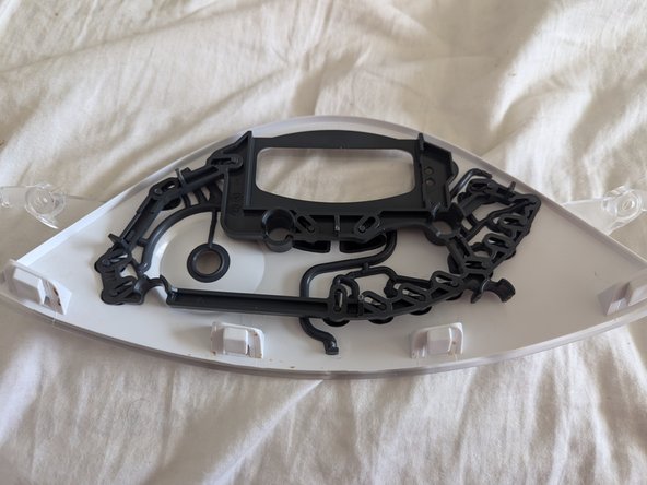

  4. Thermomix TM31 Control Panel Replacement, Remove Old Control Panel Cover: crwdns2935265:04crwdnd2935265:01crwdnd2935265:02crwdne2935265:0 Thermomix TM31 Control Panel Replacement, Remove Old Control Panel Cover: crwdns2935265:04crwdnd2935265:02crwdnd2935265:02crwdne2935265:0
    • Carefully lift the control panel cover directly vertically off.
  5. Thermomix TM31 Control Panel Replacement, Move Button Rod Guide: crwdns2935265:05crwdnd2935265:01crwdnd2935265:02crwdne2935265:0 Thermomix TM31 Control Panel Replacement, Move Button Rod Guide: crwdns2935265:05crwdnd2935265:02crwdnd2935265:02crwdne2935265:0
    • Move Button Rod Guide from old Control Panel Cover to new Control Panel Cover.

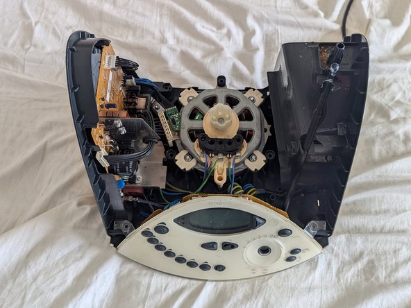

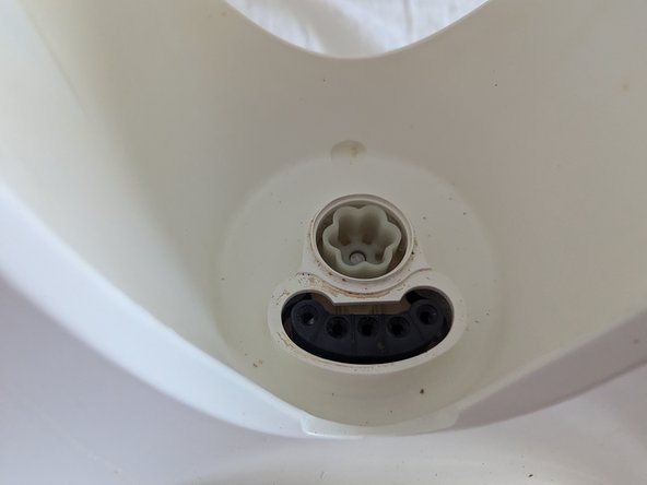

  6. Thermomix TM31 Control Panel Replacement, Reassembly tips: crwdns2935265:06crwdnd2935265:01crwdnd2935265:01crwdne2935265:0
    • Reassemble by following these instructions in reverse
    • When Reassembling ensure this Camrod is rotated towards the front. The Cam at the top needs to be engaged properly to allow the lid to lock. Leaning the base towards the front when putting the White Plastic Cover on helps with this.
