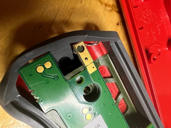

  2. ThermoWorks Thermapen Mk4  Replacement, Remove Case: crwdns2935265:02crwdnd2935265:01crwdnd2935265:02crwdne2935265:0 ThermoWorks Thermapen Mk4  Replacement, Remove Case: crwdns2935265:02crwdnd2935265:02crwdnd2935265:02crwdne2935265:0
    • Carefully open the pen, it has a tiny wire and the power actuator lever (the white lever in the top part of the picture), can get off its pin easily.
    • You can test at this point by inserting a battery and shorting the two pads circled in the second picture with your tweezers.
  3. ThermoWorks Thermapen Mk4  Replacement, Remove Circuit Board: crwdns2935265:03crwdnd2935265:01crwdnd2935265:01crwdne2935265:0
    • Remove the two screws holding the circuit board and carefully place it in the other half. The LCD is delicate.
