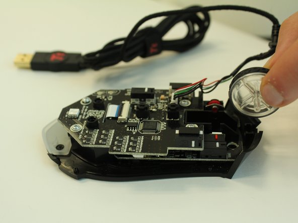

  3. Thermaltake Theron Plus Scroll Wheel Replacement, Scroll Wheel: crwdns2935265:03crwdnd2935265:01crwdnd2935265:02crwdne2935265:0 Thermaltake Theron Plus Scroll Wheel Replacement, Scroll Wheel: crwdns2935265:03crwdnd2935265:02crwdnd2935265:02crwdne2935265:0
    • Grasp the scroll wheel and wiggle it out in the direction opposite the socket.
    • Be careful not to break the small plastic arms on either side of the scroll.
