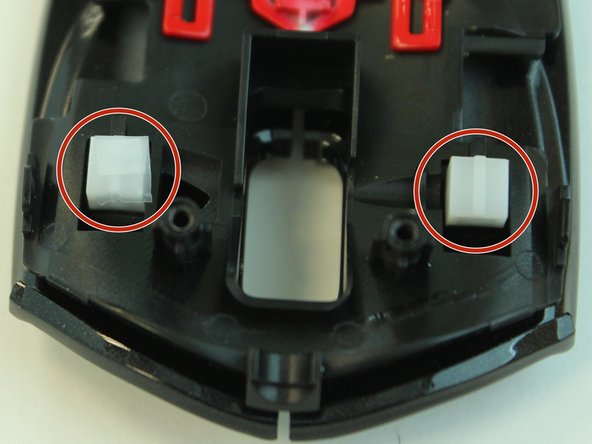

  3. Thermaltake Theron Plus Button Fix, Thermaltake Theron Plus Button Fix: crwdns2935265:03crwdnd2935265:01crwdnd2935265:03crwdne2935265:0 Thermaltake Theron Plus Button Fix, Thermaltake Theron Plus Button Fix: crwdns2935265:03crwdnd2935265:02crwdnd2935265:03crwdne2935265:0 Thermaltake Theron Plus Button Fix, Thermaltake Theron Plus Button Fix: crwdns2935265:03crwdnd2935265:03crwdnd2935265:03crwdne2935265:0
    • Flip the cover of the mouse over.

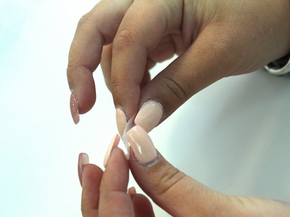

    • Fold a piece of tape over on itself. This should make both sides sticky.
    • Cover both buttons with tape to increase the surface area of each click.
