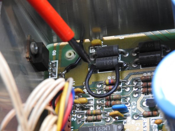

    • If you don't have a soldering iron or don't feel comfortable soldering, you can get this done with circuit test hooks!
    • Just make sure there's a firm connection to either the leg of the voltage regulator or the leg of each diode depending on the connection you are making.

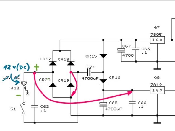

    • Take a look at the diagram: You are about to add the two jumper wires highlighted in red.

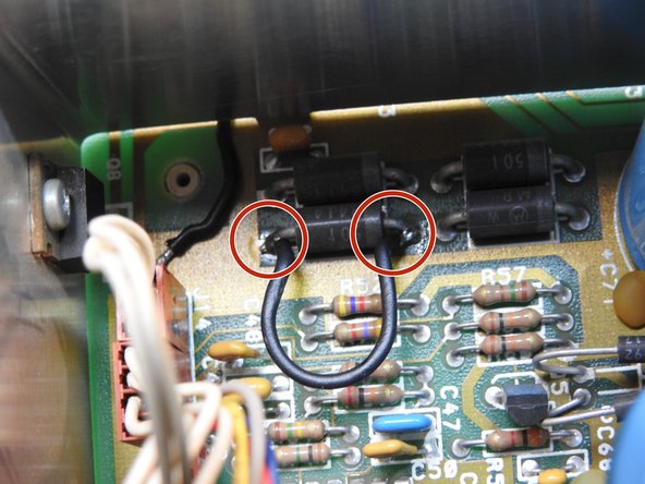

    • With the SIO connectors facing away from you and the front of the unit facing you, locate the four diodes.
    • Preferably, use 20 AWG wire for the connections.
    • Solder the first bridge on top of the CR19, which is one of the 4 large diodes (the one at the bottom left)

  6. The simple Atari 1050 Disk Drive Conversion to DC, Add the second jumper (the last one): crwdns2935265:06crwdnd2935265:01crwdnd2935265:01crwdne2935265:0
    • One end of this jumper wire will be soldered to the diode at the top right. Don't worry if it touches the diode to its left as these two are connected from factory.
    • The other end of the jumper wire, will go to the input of the 12v regulator. There is a convenient pad right next to it you can use.
    • Connecting to the output of the 12v regulator: If you use a good quality, regulated 12v power supply, you can actually connect this end of the wire to the OUTPUT of the 12V regulator for lower thermal operation (located at TP14) however,
    • by using the input pin as indicated here, you will be able to use a power supply higher than 12v, and also, the 12v regulator will serve as protection in case anything goes wrong with your power supply or for when someone accidentally connects an old 9V AC power brick to your drive.

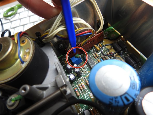

  8. The simple Atari 1050 Disk Drive Conversion to DC, Calibrate the motor speed: crwdns2935265:08crwdnd2935265:01crwdnd2935265:02crwdne2935265:0 The simple Atari 1050 Disk Drive Conversion to DC, Calibrate the motor speed: crwdns2935265:08crwdnd2935265:02crwdnd2935265:02crwdne2935265:0

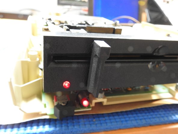

    • Chances are your drive is in working condition by now, ready to take the new 12v power supply. So, plug it in and give it a go!
    • At this point, the speed of the spinning motor may be slightly altered. So let's take care of that in this step.
    • Locate the adjusting trimpot. There is a chance it comes with silicon coating on top. Break it off gently with your hemostats until you can access the small brass screw with a flat screwdriver.
    • Load your 1050 diagnostic diskette and adjust the trimpot to the desired speed.

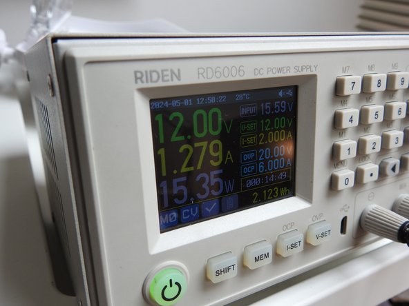

    • Current: After switching on, the current drawn from the new power supply reads 630mA (which is normal since it feeds all the electronics circuitry). When the motors are in operation, the total current reads 1,170mA (~1.2 Amps).
    • Heat: Your unit will now produce less heat: Since you disabled the voltage doubler, the 12v reg has very little work to do now, and thus, less heat to dissipate. The 5v reg has to drop 0.3v more than before, almost negligible.
    • The current readings above, mean that any nominal 12v/2A or better yet 2.5A DC power supply will be powerful enough.
