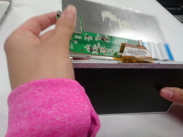

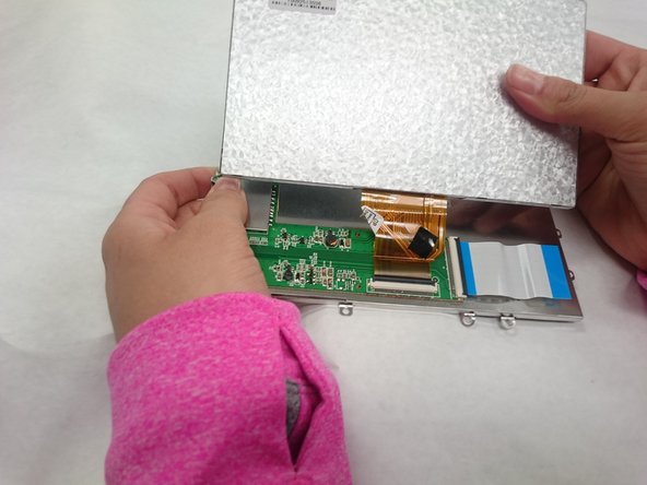

    • Remove the silver backing plate and the adhered SD port chip.
  13. The Sharper Image Literati Tablet Screen Replacement, Screen: crwdns2935265:013crwdnd2935265:01crwdnd2935265:03crwdne2935265:0 The Sharper Image Literati Tablet Screen Replacement, Screen: crwdns2935265:013crwdnd2935265:02crwdnd2935265:03crwdne2935265:0 The Sharper Image Literati Tablet Screen Replacement, Screen: crwdns2935265:013crwdnd2935265:03crwdnd2935265:03crwdne2935265:0
    • Unravel the screen from the silver backing.
  14. The Sharper Image Literati Tablet Screen Replacement: crwdns2935265:014crwdnd2935265:01crwdnd2935265:01crwdne2935265:0
    • Unclip JIF clip and remove ribbin cable.
