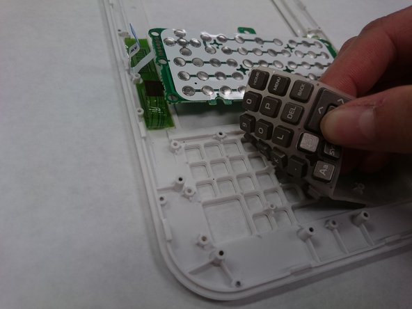

  13. The Sharper Image Literati Tablet Keyboard Replacement, Keyboard: crwdns2935265:013crwdnd2935265:01crwdnd2935265:01crwdne2935265:0
    • Remove the 10 Phillips head 4.2 mm screws using PH#00 screwdriver from the key board chip.
  14. The Sharper Image Literati Tablet Keyboard Replacement: crwdns2935265:014crwdnd2935265:01crwdnd2935265:02crwdne2935265:0 The Sharper Image Literati Tablet Keyboard Replacement: crwdns2935265:014crwdnd2935265:02crwdnd2935265:02crwdne2935265:0
    • Peal back the sensor array and keypad.

This is NOT how you open them!!! I broke one of mine doing this. The white part SLIDES UP! DO not ply it open!!! Slide it up ( it needs a LITTLE ply around the silver part. ) It comes off then there are TWO SCREWS holding the brown part down. Once you remove the two screws ( they are under the white part ) then you can slide up the brown part too.
