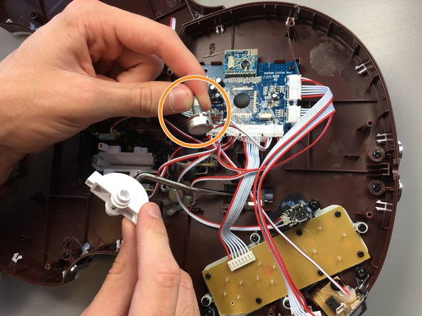

  6. The Beatles Rock Band Hofner Bass Whammy Bar Replacement: crwdns2935265:06crwdnd2935265:01crwdnd2935265:02crwdne2935265:0 The Beatles Rock Band Hofner Bass Whammy Bar Replacement: crwdns2935265:06crwdnd2935265:02crwdnd2935265:02crwdne2935265:0
    • Use a J1 Philips head screwdriver to remove one 10mm screw.
    • This will unscrew the electrical connection between the whammy bar and the blue circuit board.
    • Remove the electrical connector.
  7. The Beatles Rock Band Hofner Bass Whammy Bar Replacement: crwdns2935265:07crwdnd2935265:01crwdnd2935265:01crwdne2935265:0
    • Remove the whammy bar, since nothing should be connecting to the guitar anymore.
