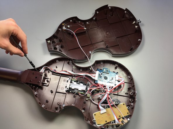

    • Flip the bass onto its backside, so that the strummer is facing the table and the battery compartment is facing you.
    • Use a J1 Phillips head screwdriver to remove ten 5mm short screws.
    • Use a J1 Phillips head screwdriver to remove four 5mm long screws.
  2. The Beatles Rock Band Hofner Bass Strummer Bar Replacement: crwdns2935265:02crwdnd2935265:01crwdnd2935265:01crwdne2935265:0
    • Flip the bass to the front, with the strummer and fret buttons facing you.
    • Use a J1 Phillips head screwdriver to remove two 10mm silver, short screws.
  3. The Beatles Rock Band Hofner Bass Strummer Bar Replacement: crwdns2935265:03crwdnd2935265:01crwdnd2935265:02crwdne2935265:0 The Beatles Rock Band Hofner Bass Strummer Bar Replacement: crwdns2935265:03crwdnd2935265:02crwdnd2935265:02crwdne2935265:0
    • Flip the bass on its back again, so that the strummer is facing down and the battery compartment is facing you.
    • Pull off the back whole panel so that the bass is now open.
  4. The Beatles Rock Band Hofner Bass Strummer Bar Replacement, Strummer Bar: crwdns2935265:04crwdnd2935265:01crwdnd2935265:01crwdne2935265:0
    • Use a J1 Phillips head screwdriver to remove the four 10mm screws at the corners of the black casing.
  5. The Beatles Rock Band Hofner Bass Strummer Bar Replacement: crwdns2935265:05crwdnd2935265:01crwdnd2935265:01crwdne2935265:0
    • Remove the connection from the board, so that the strummer is no longer connected.
    • Carefully take the strummer out of the guitar, now that it is no longer connected.
    • Now the strummer is completely removed.
