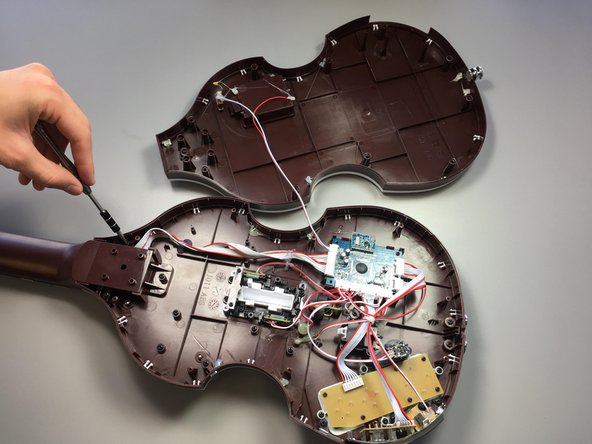

    • Flip the guitar onto its backside, so that the strummer is facing the table and the battery compartment is facing you.
    • Use a J1 Phillips head screwdriver to remove ten 5mm short screws.
    • Use a J1 Phillips head screwdriver to remove four 5mm long screws.
  2. The Beatles Rock Band Hofner Bass Fret Buttons Replacement: crwdns2935265:02crwdnd2935265:01crwdnd2935265:01crwdne2935265:0
    • Flip the guitar to the front, with the strummer and fret buttons facing you.
    • Use a J1 Phillips head screwdriver to remove two 10mm silver, short screws.
  3. The Beatles Rock Band Hofner Bass Fret Buttons Replacement: crwdns2935265:03crwdnd2935265:01crwdnd2935265:02crwdne2935265:0 The Beatles Rock Band Hofner Bass Fret Buttons Replacement: crwdns2935265:03crwdnd2935265:02crwdnd2935265:02crwdne2935265:0
    • Flip the guitar on its back again, so that the strummer is facing down and the battery compartment is facing you.
    • Pull off the back whole panel so that the guitar is now open.

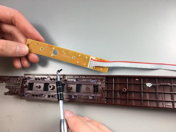

  8. The Beatles Rock Band Hofner Bass Fret Buttons Replacement: crwdns2935265:08crwdnd2935265:01crwdnd2935265:02crwdne2935265:0 The Beatles Rock Band Hofner Bass Fret Buttons Replacement: crwdns2935265:08crwdnd2935265:02crwdnd2935265:02crwdne2935265:0
    • Remove the 10mm screw on the fret buttons with a J1 Phillips screwdriver.
    • Remove the fret buttons.
