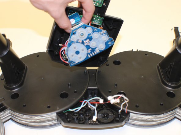

    • Remove the four Phillips size J1 screws from the corners of the bottom module.
    • Removing the screws requires a thin screwdriver.
  2. The Beatles Rock Band Drum Set Front Button Replacement: crwdns2935265:02crwdnd2935265:01crwdnd2935265:03crwdne2935265:0 The Beatles Rock Band Drum Set Front Button Replacement: crwdns2935265:02crwdnd2935265:02crwdnd2935265:03crwdne2935265:0 The Beatles Rock Band Drum Set Front Button Replacement: crwdns2935265:02crwdnd2935265:03crwdnd2935265:03crwdne2935265:0
    • Open the bottom module. Disconnect the five wire clips as shown in the pictures.
  3. The Beatles Rock Band Drum Set Front Button Replacement: crwdns2935265:03crwdnd2935265:01crwdnd2935265:02crwdne2935265:0 The Beatles Rock Band Drum Set Front Button Replacement: crwdns2935265:03crwdnd2935265:02crwdnd2935265:02crwdne2935265:0
    • Remove the four Phillips #1 sized screws holding the main circuit board. Rotate the board up and out, exposing the buttons.
  4. The Beatles Rock Band Drum Set Front Button Replacement: crwdns2935265:04crwdnd2935265:01crwdnd2935265:01crwdne2935265:0
    • The buttons can be pushed up from the bottom to be removed.
