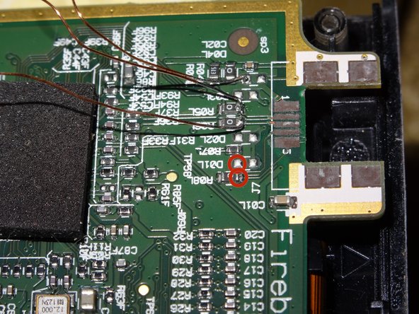

    • Inspect power connector damage. This calculator has all of the power contacts torn off.
    • Follow the traces to see where to solder on replacement leads.
    • I guessed the locations of where new leads were needed and got lucky.

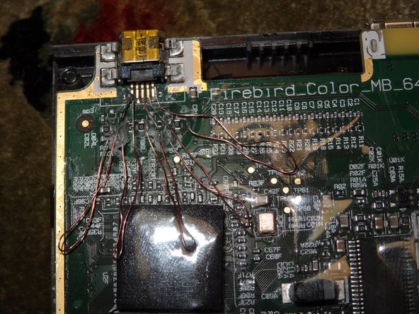

  9. Texas Instruments TI-Nspire CX Power Connector Replacement: crwdns2935265:09crwdnd2935265:01crwdnd2935265:03crwdne2935265:0 Texas Instruments TI-Nspire CX Power Connector Replacement: crwdns2935265:09crwdnd2935265:02crwdnd2935265:03crwdne2935265:0 Texas Instruments TI-Nspire CX Power Connector Replacement: crwdns2935265:09crwdnd2935265:03crwdnd2935265:03crwdne2935265:0
    • Use enameled wire or other types of coated wire.
    • Do NOT use bare copper wire. Although it is used in this tutorial, bare wire can short and permanently brick the calculator.
    • Pre-tin the leads so solder sticks more easily onto the copper. Do this by adding solder to tip of soldering iron, then rubbing across one of the ends of the replacement wire.
    • Do this to both sides of all the wires, tin both the front and back each single end. The tin does not automatically flow to both sides, therefore tediously tin the front, then back of one side of wire.
    • A steady hand helps with soldering to the PCB.
  10. Texas Instruments TI-Nspire CX Power Connector Replacement: crwdns2935265:010crwdnd2935265:01crwdnd2935265:01crwdne2935265:0
    • Tape off the board with electrical tape or Kapton tape to prevent shorting.
    • Soldering the replacement leads in the wrong locations could cause unintended behavior, or a permanently bricked calculator.
    • This solder layout lead to failure of data transfer operation. Charging was ok.
  11. Texas Instruments TI-Nspire CX Power Connector Replacement: crwdns2935265:011crwdnd2935265:01crwdnd2935265:03crwdne2935265:0 Texas Instruments TI-Nspire CX Power Connector Replacement: crwdns2935265:011crwdnd2935265:02crwdnd2935265:03crwdne2935265:0 Texas Instruments TI-Nspire CX Power Connector Replacement: crwdns2935265:011crwdnd2935265:03crwdnd2935265:03crwdne2935265:0
    • Test before sealing the leads with superglue or tape.
    • Be sure not to touch any leads together.
    • The new solder joints can break easily. Take care not to excessively or repeatedly bend leads.
    • Superglue the support contacts back to the board, excessive pressure when charging may break the power plug off a second time.
    • Avoid using superglue that flows easily. This could clog up the new port or create a mess as shown in the photos.
  12. Texas Instruments TI-Nspire CX Power Connector Replacement: crwdns2935265:012crwdnd2935265:01crwdnd2935265:02crwdne2935265:0 Texas Instruments TI-Nspire CX Power Connector Replacement: crwdns2935265:012crwdnd2935265:02crwdnd2935265:02crwdne2935265:0

Hello all. I was able to complete this guide successfully however please do not solder like the Author did. I was able to get data working as well. The steps to getting the calculator open were awesome but after that please do not follow. I also found a small flathead will work for taking off the “clutch” screws. I was able to get a USB-C connector working with data transfer. I used insulated cables not thin strands of copper which have a high likely hood of shorting and no need to tape over anything. Also for those solders going to the bridge connectors, you can actually remove those bridge resistors as they are 0 ohms. Effectively doing nothing but acting as a bridge between pads. Texas Instruments must use this same PCB design for multiple things.
