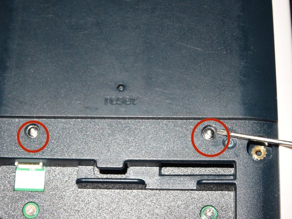

  2. Texas Instruments TI-Nspire CX Defective Button Repair: crwdns2935265:02crwdnd2935265:01crwdnd2935265:03crwdne2935265:0 Texas Instruments TI-Nspire CX Defective Button Repair: crwdns2935265:02crwdnd2935265:02crwdnd2935265:03crwdne2935265:0 Texas Instruments TI-Nspire CX Defective Button Repair: crwdns2935265:02crwdnd2935265:03crwdnd2935265:03crwdne2935265:0
    • Remove the feet from the top of the calculator to reveal the top clutch screws.
    • Unscrew the clutch screws, the torx bottom screws, and the battery drawer screws.
    • Use a 1mm flathead screwdriver for the clutch screws.
    • You will need to switch your screwdriver bit for the torx screws. Be careful not to strip the screws.

    • Unscrew the two clutch screws above the battery case, using the 1mm flathead screwdriver.

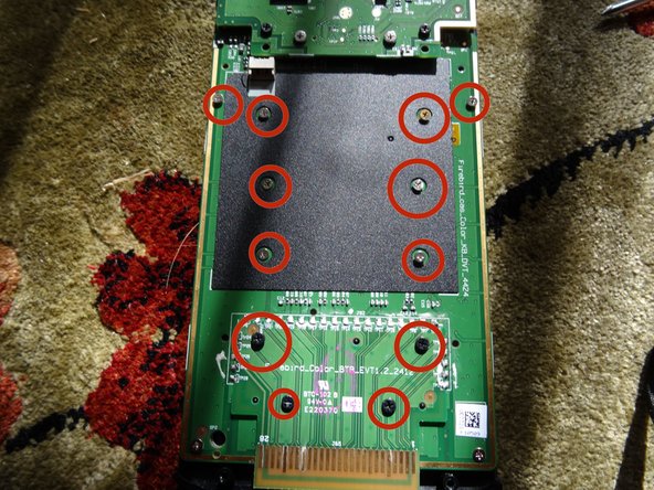

  5. Texas Instruments TI-Nspire CX Defective Button Repair: crwdns2935265:05crwdnd2935265:01crwdnd2935265:02crwdne2935265:0 Texas Instruments TI-Nspire CX Defective Button Repair: crwdns2935265:05crwdnd2935265:02crwdnd2935265:02crwdne2935265:0
    • Unscrew the sixteen screws circled in the pictures.
    • Four of these screws are around the connector, while the other twelve are on the circuit board itself.

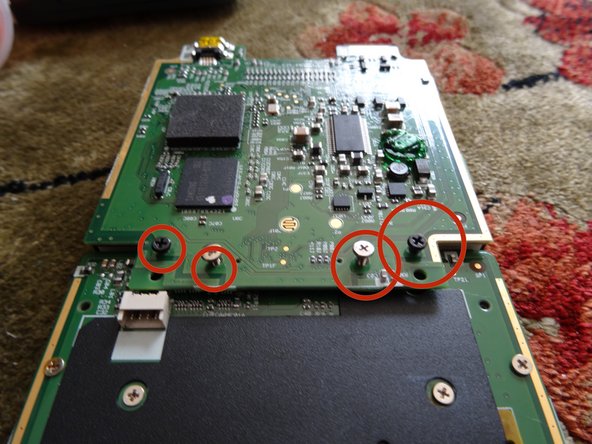

  6. Texas Instruments TI-Nspire CX Defective Button Repair: crwdns2935265:06crwdnd2935265:01crwdnd2935265:01crwdne2935265:0
    • The internal spacers may fall out while you are working. Make sure to put them somewhere safe.
  7. Texas Instruments TI-Nspire CX Defective Button Repair: crwdns2935265:07crwdnd2935265:01crwdnd2935265:01crwdne2935265:0
    • Pull the top circuit board and the screen off. You should not need much force to undo the connector between them.
    • Although your calculator is in several pieces now, do not worry. There is little chance of causing damage.

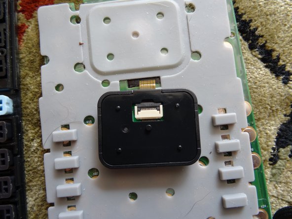

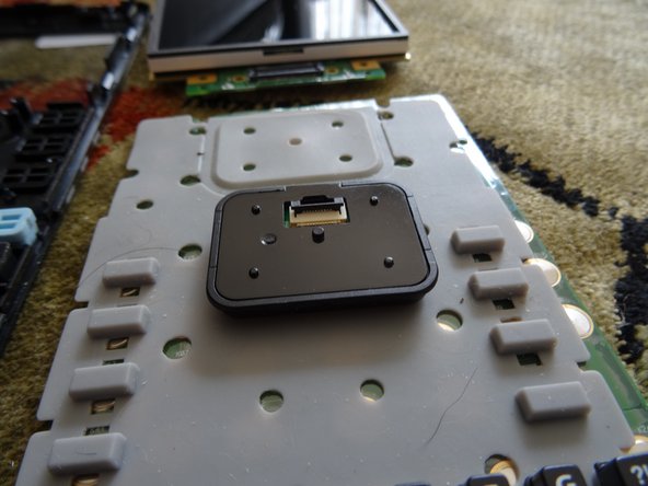

  8. Texas Instruments TI-Nspire CX Defective Button Repair: crwdns2935265:08crwdnd2935265:01crwdnd2935265:03crwdne2935265:0 Texas Instruments TI-Nspire CX Defective Button Repair: crwdns2935265:08crwdnd2935265:02crwdnd2935265:03crwdne2935265:0 Texas Instruments TI-Nspire CX Defective Button Repair: crwdns2935265:08crwdnd2935265:03crwdnd2935265:03crwdne2935265:0
    • Take the keyboard off. The buttons will fall out now, so take care to put them somewhere safe.
    • Be careful not to lose any of the buttons.
    • Take the mouse flex cable off, otherwise it will dangle. Flip up the tab.

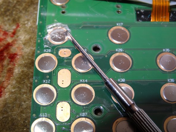

  9. Texas Instruments TI-Nspire CX Defective Button Repair: crwdns2935265:09crwdnd2935265:01crwdnd2935265:03crwdne2935265:0 Texas Instruments TI-Nspire CX Defective Button Repair: crwdns2935265:09crwdnd2935265:02crwdnd2935265:03crwdne2935265:0 Texas Instruments TI-Nspire CX Defective Button Repair: crwdns2935265:09crwdnd2935265:03crwdnd2935265:03crwdne2935265:0

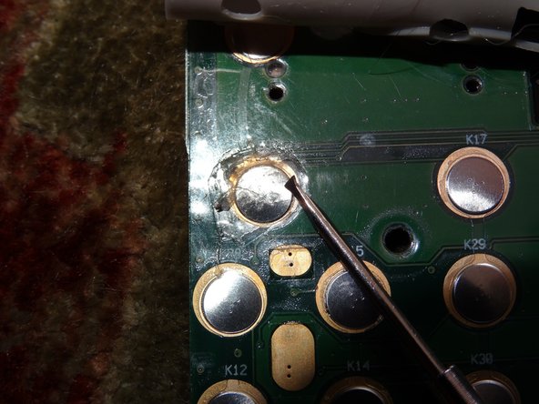

    • On the circuit board, cut around the failing button with a safety knife. Once it is loose, peel it off delicately with a screwdriver or tweezers.
    • Clean the button with rubbing alcohol.
    • Be careful not to dig into the circuit board with the knife. This could seriously damage your calculator!
    • Place the button back on the circuit board, then use a small amount of adhesive tape to reattach it.

The black circular spacers shown at step 6 go on the mounting brackets for the two outermost screws holding the screen onto the mainboard. On the first picture for step 5, if you numbered the circled screws from left to right, those would be screws 1 and 4.
I didn’t have a screwdriver for the clutch screws of the back cover, but a thin, pointed knife tip did the job.

Thanks a lot! Spilled coffee in mine, had to wash all the buttons individually to solve the sticky button issue, worked like a treat.
