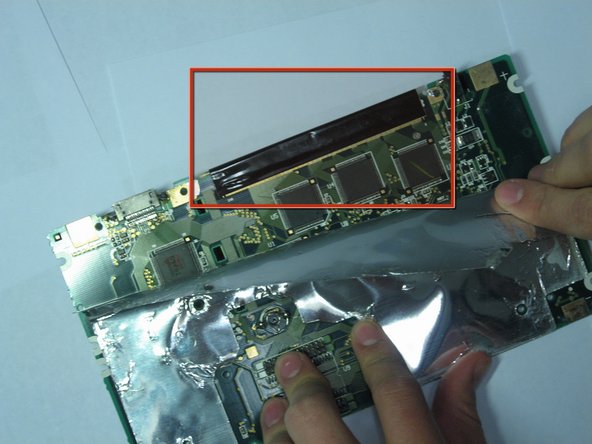

  13. Texas Instruments TI-92 Display Replacement: crwdns2935265:013crwdnd2935265:01crwdnd2935265:02crwdne2935265:0 Texas Instruments TI-92 Display Replacement: crwdns2935265:013crwdnd2935265:02crwdnd2935265:02crwdne2935265:0
    • Lift up on the material covering the motherboard starting from the upper right corner. Peel foil back only about half way down.
    • Make sure to slowly lift up on the plastic of the covering material and not the foil or the foil will rip.

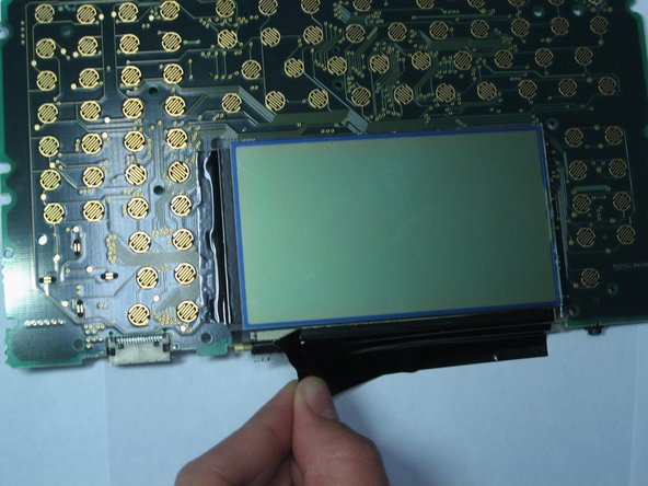

  14. Texas Instruments TI-92 Display Replacement: crwdns2935265:014crwdnd2935265:01crwdnd2935265:02crwdne2935265:0 Texas Instruments TI-92 Display Replacement: crwdns2935265:014crwdnd2935265:02crwdnd2935265:02crwdne2935265:0
    • Now slowly lift up the black tape located at the top of the calculator.
    • You will need to replace tape if removed so if you do not have this replacement part do not attempt to remove it

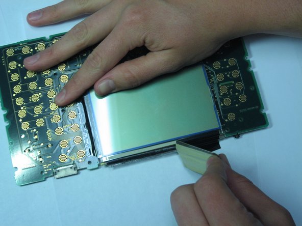

  15. Texas Instruments TI-92 Display Replacement: crwdns2935265:015crwdnd2935265:01crwdnd2935265:03crwdne2935265:0 Texas Instruments TI-92 Display Replacement: crwdns2935265:015crwdnd2935265:02crwdnd2935265:03crwdne2935265:0 Texas Instruments TI-92 Display Replacement: crwdns2935265:015crwdnd2935265:03crwdnd2935265:03crwdne2935265:0
    • Tilt the calculator up from the front so that you can see the LCD screen
    • Finish removing the black tape on this side of the motherboard.
