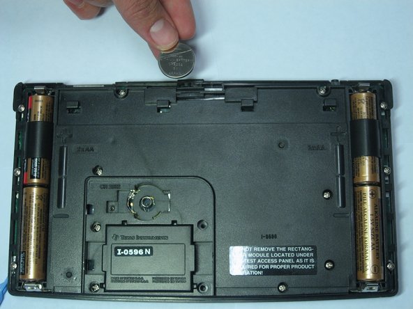

  4. Texas Instruments TI-92 Backup Battery Replacement, Backup Battery: crwdns2935265:04crwdnd2935265:01crwdnd2935265:01crwdne2935265:0
    • Before removing the backup battery make sure your AA batteries are installed so that there is no loss of information.
    • Using a #00 Philip Screwdriver remove the 19mm screw located near the center of the back of the calculator on the panel with words "Test Access"
  5. Texas Instruments TI-92 Backup Battery Replacement: crwdns2935265:05crwdnd2935265:01crwdnd2935265:01crwdne2935265:0
    • Remove the screw and lift the panel to access battery.
  6. Texas Instruments TI-92 Backup Battery Replacement: crwdns2935265:06crwdnd2935265:01crwdnd2935265:02crwdne2935265:0 Texas Instruments TI-92 Backup Battery Replacement: crwdns2935265:06crwdnd2935265:02crwdnd2935265:02crwdne2935265:0
    • The backup battery can now be seen underneath a small metal cover held by a screw.
    • Using the same screwdriver, unscrew the 4.6mm screw located under the panel and left of the backup battery.

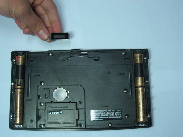

  7. Texas Instruments TI-92 Backup Battery Replacement: crwdns2935265:07crwdnd2935265:01crwdnd2935265:03crwdne2935265:0 Texas Instruments TI-92 Backup Battery Replacement: crwdns2935265:07crwdnd2935265:02crwdnd2935265:03crwdne2935265:0 Texas Instruments TI-92 Backup Battery Replacement: crwdns2935265:07crwdnd2935265:03crwdnd2935265:03crwdne2935265:0
    • Remove the metal cover keeping the backup battery in place.

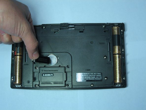

  8. Texas Instruments TI-92 Backup Battery Replacement: crwdns2935265:08crwdnd2935265:01crwdnd2935265:02crwdne2935265:0 Texas Instruments TI-92 Backup Battery Replacement: crwdns2935265:08crwdnd2935265:02crwdnd2935265:02crwdne2935265:0
    • Use an Ipod Opening Tool or a similar tool to pull up on the right side of the backup battery.
    • The battery should pop out of position.
  9. Texas Instruments TI-92 Backup Battery Replacement: crwdns2935265:09crwdnd2935265:01crwdnd2935265:02crwdne2935265:0 Texas Instruments TI-92 Backup Battery Replacement: crwdns2935265:09crwdnd2935265:02crwdnd2935265:02crwdne2935265:0
    • After the battery has been tilted out of its socket, simply remove it with your hands.
