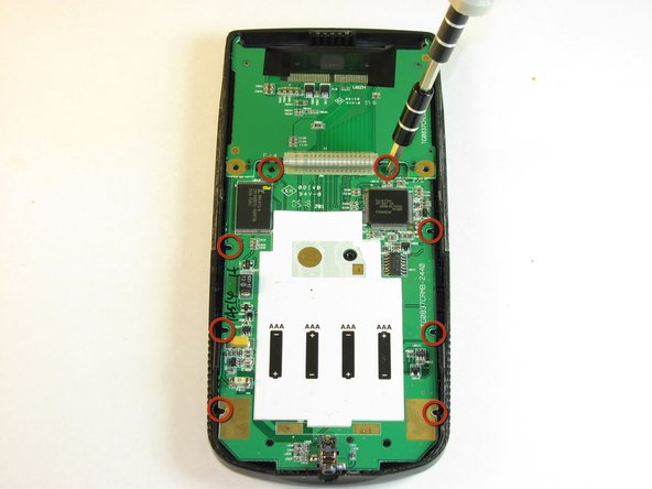

  6. Texas Instruments TI-83 Plus Keyboard Mat Replacement, Motherboard & Screen: crwdns2935265:06crwdnd2935265:01crwdnd2935265:02crwdne2935265:0 Texas Instruments TI-83 Plus Keyboard Mat Replacement, Motherboard & Screen: crwdns2935265:06crwdnd2935265:02crwdnd2935265:02crwdne2935265:0
    • Keep the screen face-down during this step. Only the motherboard is attached to the face-plate and the screen may fall out.
    • Remove the eight (8) 5mm Philips #00 screws on the motherboard.
  7. Texas Instruments TI-83 Plus Keyboard Mat Replacement: crwdns2935265:07crwdnd2935265:01crwdnd2935265:02crwdne2935265:0 Texas Instruments TI-83 Plus Keyboard Mat Replacement: crwdns2935265:07crwdnd2935265:02crwdnd2935265:02crwdne2935265:0
    • Carefully remove the motherboard and screen. Grab the board by its side with one hand and the screen with the other. Carefully lift the two parts up.
    • Keep the face-plate face-down to prevent the keys from falling out.

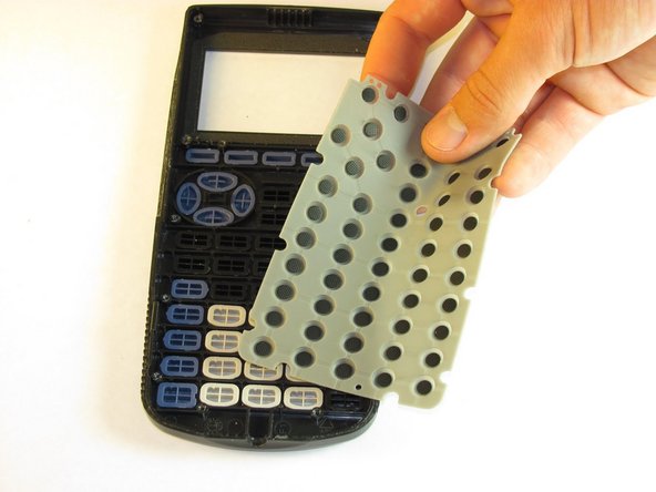

  8. Texas Instruments TI-83 Plus Keyboard Mat Replacement, Keyboard Mat: crwdns2935265:08crwdnd2935265:01crwdnd2935265:02crwdne2935265:0 Texas Instruments TI-83 Plus Keyboard Mat Replacement, Keyboard Mat: crwdns2935265:08crwdnd2935265:02crwdnd2935265:02crwdne2935265:0
    • Remove light gray rubber keyboard mat.
    • Keep your calculator face down to ensure the individual keys do not fall out.
  9. Texas Instruments TI-83 Plus Keyboard Mat Replacement: crwdns2935265:09crwdnd2935265:01crwdnd2935265:01crwdne2935265:0
    • Clean the contacts on the keyboard with a soft cloth.
