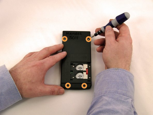

  3. Texas Instruments TI-80 Back Casing Replacement, Back Case: crwdns2935265:03crwdnd2935265:01crwdnd2935265:03crwdne2935265:0 Texas Instruments TI-80 Back Casing Replacement, Back Case: crwdns2935265:03crwdnd2935265:02crwdnd2935265:03crwdne2935265:0 Texas Instruments TI-80 Back Casing Replacement, Back Case: crwdns2935265:03crwdnd2935265:03crwdnd2935265:03crwdne2935265:0
    • Using a Torx, T-6 star-bit screwdriver, unscrew four 7.38 mm screws from battery housing.
    • Unscrew four 7.15 mm screws from back casing.

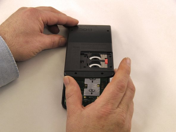

    • Using the blue plastic opener tool along the seam of the case, pry off front casing.
    • Start prying from the bottom of the calculator as the casing hooks into the top.
