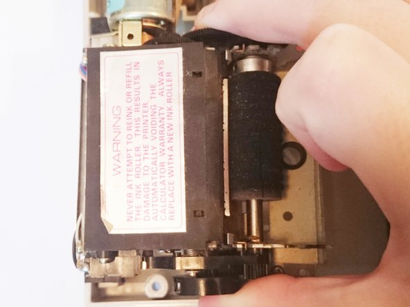

    • Flip the calculator over and remove the 4 main 10mm screws with a PH1 screwdriver.
  2. Texas Instruments TI-5130 Printer Unit  Replacement: crwdns2935265:02crwdnd2935265:01crwdnd2935265:01crwdne2935265:0
    • Flip the calculator back over and remove the top cover.
  3. Texas Instruments TI-5130 Printer Unit  Replacement: crwdns2935265:03crwdnd2935265:01crwdnd2935265:01crwdne2935265:0
    • Disconnect the printing unit from the motherboard by pulling up on the connector – located in the bottom left of the motherboard.
  4. Texas Instruments TI-5130 Printer Unit  Replacement: crwdns2935265:04crwdnd2935265:01crwdnd2935265:01crwdne2935265:0
    • Remove the ink cartridge by pushing the tab back then lifting it out to gain access to the screw that holds the printer in place.
  5. Texas Instruments TI-5130 Printer Unit  Replacement: crwdns2935265:05crwdnd2935265:01crwdnd2935265:02crwdne2935265:0 Texas Instruments TI-5130 Printer Unit  Replacement: crwdns2935265:05crwdnd2935265:02crwdnd2935265:02crwdne2935265:0
    • Using a PH1 screwdriver remove the 10mm screw that holds down the printer unit.
    • Remove the printer unit by lifting it up.
