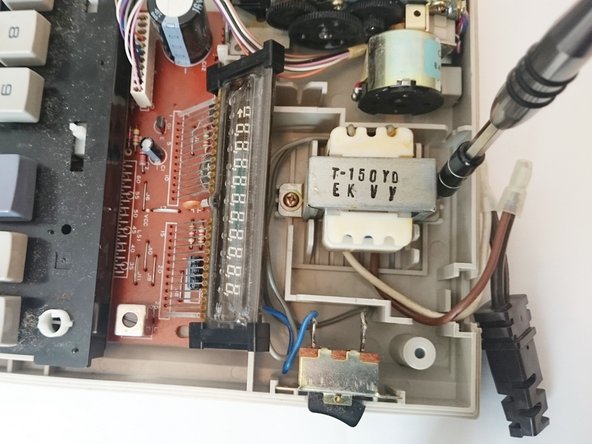

    • Flip the calculator over and remove the 4 main 10mm screws with a PH1 screwdriver.
  2. Texas Instruments TI-5130 Power Cord Replacement: crwdns2935265:02crwdnd2935265:01crwdnd2935265:02crwdne2935265:0 Texas Instruments TI-5130 Power Cord Replacement: crwdns2935265:02crwdnd2935265:02crwdnd2935265:02crwdne2935265:0
    • Remove the top cover.
    • Gently pull up on the power cord to remove it from the back cover.
  3. Texas Instruments TI-5130 Power Cord Replacement: crwdns2935265:03crwdnd2935265:01crwdnd2935265:02crwdne2935265:0 Texas Instruments TI-5130 Power Cord Replacement: crwdns2935265:03crwdnd2935265:02crwdnd2935265:02crwdne2935265:0
    • This step is optional; however it makes it easier to work.
    • Using a PH1 screwdriver remove the two 10mm screws that hold down the transformer.
    • Gently remove the transformer.
    • Make sure that the calculator is not plugged in.
  4. Texas Instruments TI-5130 Power Cord Replacement: crwdns2935265:04crwdnd2935265:01crwdnd2935265:02crwdne2935265:0 Texas Instruments TI-5130 Power Cord Replacement: crwdns2935265:04crwdnd2935265:02crwdnd2935265:02crwdne2935265:0
    • Use a wire cutter to cut off the white cap and expose the wires. Try to cut close to the tip of the white cap - to leave as much wire as possible.
    • Note that there are 2 sets of wires connected to the power cord. Do each set of wires separately.
  5. Texas Instruments TI-5130 Power Cord Replacement: crwdns2935265:05crwdnd2935265:01crwdnd2935265:02crwdne2935265:0 Texas Instruments TI-5130 Power Cord Replacement: crwdns2935265:05crwdnd2935265:02crwdnd2935265:02crwdne2935265:0
    • Use a wire stripper to remove 1/2” of the protective covering on each of the wires.
  6. Texas Instruments TI-5130 Power Cord Replacement: crwdns2935265:06crwdnd2935265:01crwdnd2935265:02crwdne2935265:0 Texas Instruments TI-5130 Power Cord Replacement: crwdns2935265:06crwdnd2935265:02crwdnd2935265:02crwdne2935265:0
    • Twist the exposed section of the 2 wires together.
    • Twist a new cap over the exposed wires. Make sure that the cap covers all of the exposed wire.
    • Repeat steps 4-6 for the second set of wires.
  7. Texas Instruments TI-5130 Power Cord Replacement: crwdns2935265:07crwdnd2935265:01crwdnd2935265:01crwdne2935265:0
    • Replace the transformer and ensure that the new wire caps fit in the space shown.
    • Plug in the new power cord and test the calculator before replacing the top cover.
