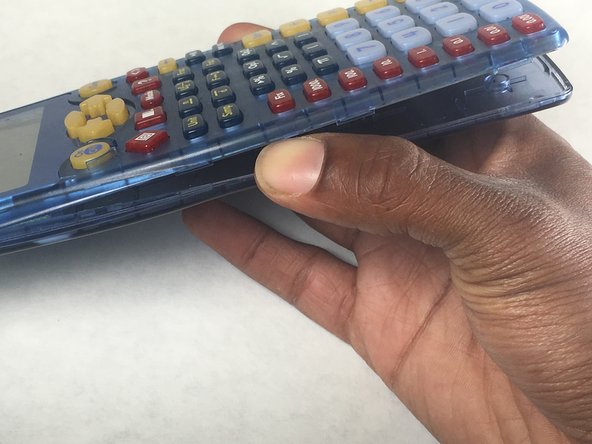

    • With an iFixit opening tool, pry apart a total of 3 notches on the top and bottom of the calculator.

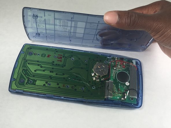

    • Separate the two panels to reveal the calculator's green circuit board.

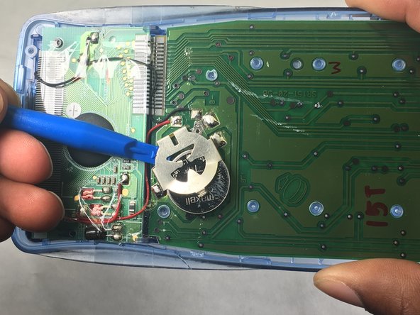

    • Using the iFixit opening tool , slide underneath the battery cover until the battery comes out.

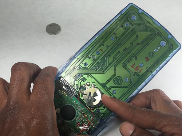

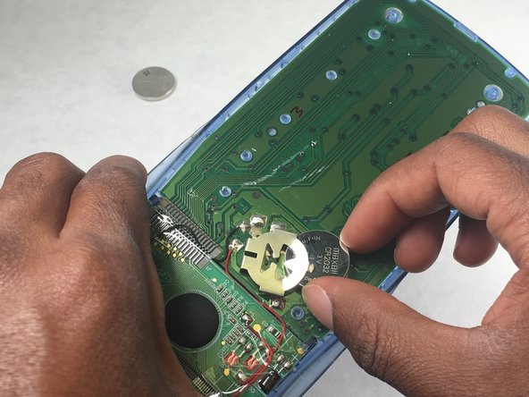

    • Remove the old battery and insert the new battery.
    • Properly dispose or recycle the old battery.
