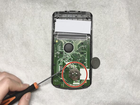

    • Switch off the calculator by pressing the button at the top right corner.
  2. Texas Instruments TI BA II PLUS  Battery Replacement: crwdns2935265:02crwdnd2935265:01crwdnd2935265:01crwdne2935265:0
    • Turn over the calculator so the backside of the calculator is facing upwards.
    • Remove the four 2mm Phillips #00 screws from the bottom cover.
  3. Texas Instruments TI BA II PLUS  Battery Replacement: crwdns2935265:03crwdnd2935265:01crwdnd2935265:01crwdne2935265:0
    • Open a small gap at the bottom of the calculator, using a spudger or your fingers.
    • Move your thumb from the bottom edge to the top.
    • Be gentle when separating the cases to avoid breaking the clips.
  4. Texas Instruments TI BA II PLUS  Battery Replacement: crwdns2935265:04crwdnd2935265:01crwdnd2935265:03crwdne2935265:0 Texas Instruments TI BA II PLUS  Battery Replacement: crwdns2935265:04crwdnd2935265:02crwdnd2935265:03crwdne2935265:0 Texas Instruments TI BA II PLUS  Battery Replacement: crwdns2935265:04crwdnd2935265:03crwdnd2935265:03crwdne2935265:0
    • Use a spudger to remove the battery from the cage at the bottom of the motherboard.
  5. Texas Instruments TI BA II PLUS  Battery Replacement: crwdns2935265:05crwdnd2935265:01crwdnd2935265:01crwdne2935265:0
    • Replace the battery with the new CR2032 Lithium Battery in the battery cage.
  6. Texas Instruments TI BA II PLUS  Battery Replacement: crwdns2935265:06crwdnd2935265:01crwdnd2935265:02crwdne2935265:0 Texas Instruments TI BA II PLUS  Battery Replacement: crwdns2935265:06crwdnd2935265:02crwdnd2935265:02crwdne2935265:0
    • Reattach the calculator cases, beginning from the top edge.
    • Use the Phillips #00 screwdriver to replace the 2.00 mm screws.

Great guide, thanks! The spudger was necessary for me to separate the case, as I couldn’t separate it with my fingers alone.
Jonathan - crwdns2934203:0crwdne2934203:0
使用2.5mm的螺丝刀更好,2mm可能会打滑
