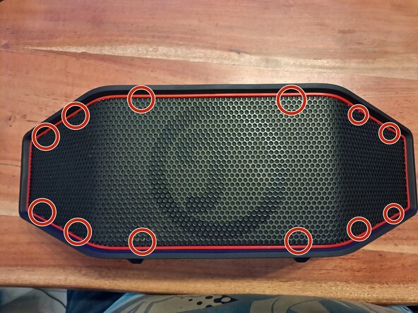

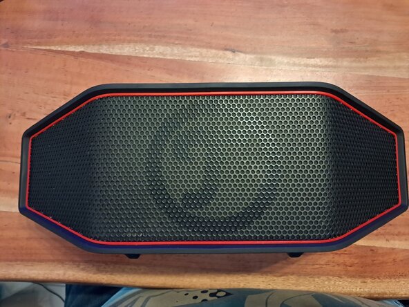

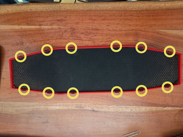

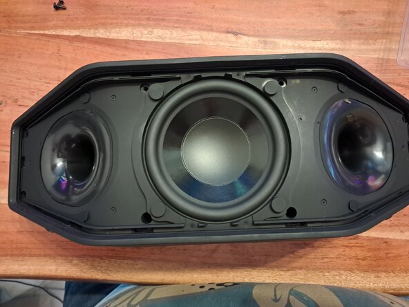

    • Insert a thin screwdriver into the outer holes of the front grille at the edge of the grille and use the outer rubber rim of the device as a lever. Pry the grille out all the way.
    • I have marked the points where the tabs are secured in the housing in red

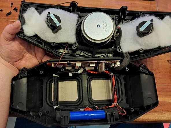

  2. Teufel Rockster Cross battery replacement: crwdns2935265:02crwdnd2935265:01crwdnd2935265:03crwdne2935265:0 Teufel Rockster Cross battery replacement: crwdns2935265:02crwdnd2935265:02crwdnd2935265:03crwdne2935265:0 Teufel Rockster Cross battery replacement: crwdns2935265:02crwdnd2935265:03crwdnd2935265:03crwdne2935265:0

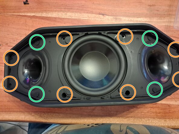

    • Remove the rubber plugs from the screw holes marked in green
    • Remove the screws from all marked holes.
    • You can now pull the front part of the housing, with the speakers, forward and away from the body.
    • CAUTION: Make sure that the rubber seal remains in the groove of the front element.

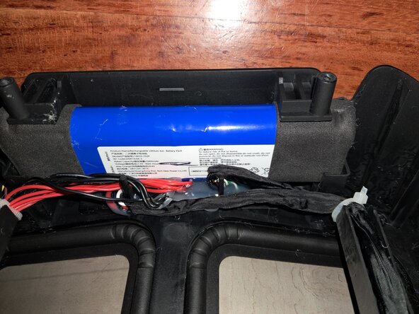

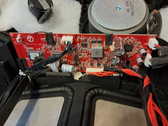

  3. Teufel Rockster Cross battery replacement: crwdns2935265:03crwdnd2935265:01crwdnd2935265:01crwdne2935265:0

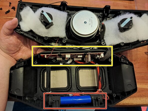

    • The battery is located at the bottom (marked in red).
    • The circuit board is located at the top. It is glued to the bottom of the body.
    • CAUTION: Do not remove the adhesive from the body, as it also contains the ribbon cable for the buttons on the back of the device.

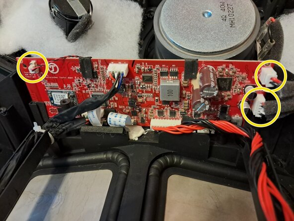

  4. Teufel Rockster Cross battery replacement: crwdns2935265:04crwdnd2935265:01crwdnd2935265:02crwdne2935265:0 Teufel Rockster Cross battery replacement: crwdns2935265:04crwdnd2935265:02crwdnd2935265:02crwdne2935265:0

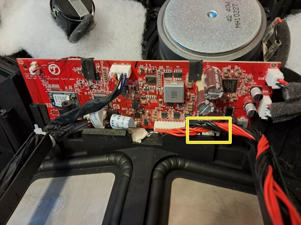

    • Disconnect the three yellow connectors to remove the front panel.
  5. Teufel Rockster Cross battery replacement: crwdns2935265:05crwdnd2935265:01crwdnd2935265:03crwdne2935265:0 Teufel Rockster Cross battery replacement: crwdns2935265:05crwdnd2935265:02crwdnd2935265:03crwdne2935265:0 Teufel Rockster Cross battery replacement: crwdns2935265:05crwdnd2935265:03crwdnd2935265:03crwdne2935265:0

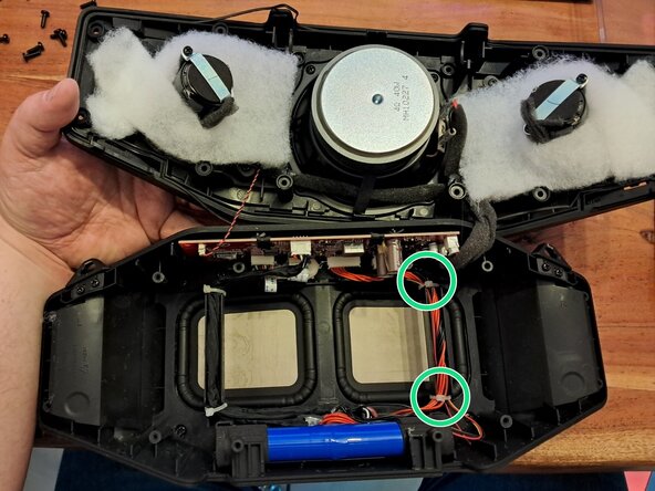

    • Disconnect the yellow-marked connector from the battery.
    • Cut the cable ties from the bar on the left side. See green markings.
    • Now you can remove the battery from the holder at the bottom of the body, by turning it.

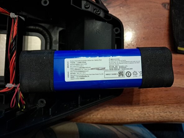

  6. Teufel Rockster Cross battery replacement: crwdns2935265:06crwdnd2935265:01crwdnd2935265:03crwdne2935265:0 Teufel Rockster Cross battery replacement: crwdns2935265:06crwdnd2935265:02crwdnd2935265:03crwdne2935265:0 Teufel Rockster Cross battery replacement: crwdns2935265:06crwdnd2935265:03crwdnd2935265:03crwdne2935265:0

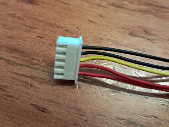

    • Battery specifications:
    • 7.4V
    • 5800mAh
    • 5-pin connector
    • Model: 18650-2S2P
    • IEC code: 2INR19/66-2
    • GB31241-2014
    • Maximum length 135 mm, width 22 mm, depth 40 mm
