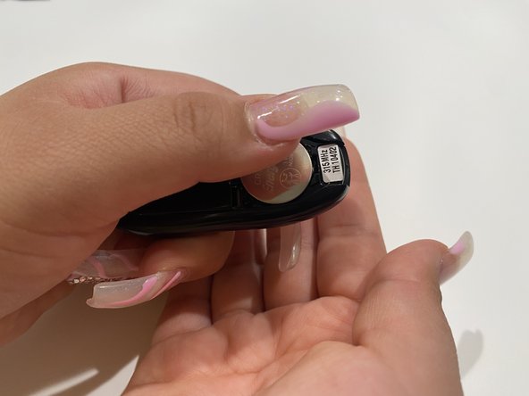

    • Insert the flat end of a spudger into the entry point at the top of the key fob.
    • Lightly push the spudger under the battery.
    • Remove the battery from the key fob.
  4. Tesla Model S Key Fob Battery Replacement: crwdns2935265:04crwdnd2935265:01crwdnd2935265:03crwdne2935265:0 Tesla Model S Key Fob Battery Replacement: crwdns2935265:04crwdnd2935265:02crwdnd2935265:03crwdne2935265:0 Tesla Model S Key Fob Battery Replacement: crwdns2935265:04crwdnd2935265:03crwdnd2935265:03crwdne2935265:0
    • With your fingers, insert a new CR2032 battery into the opening.
    • Ensure correct placement of the battery by having the writing facing up toward you and the blank side with a number facing down inside the battery opening.
    • Push the battery with your thumb to lock it into place.

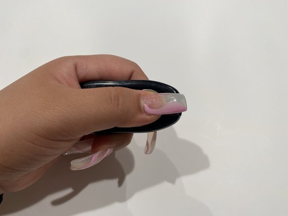

  5. Tesla Model S Key Fob Battery Replacement: crwdns2935265:05crwdnd2935265:01crwdnd2935265:03crwdne2935265:0 Tesla Model S Key Fob Battery Replacement: crwdns2935265:05crwdnd2935265:02crwdnd2935265:03crwdne2935265:0 Tesla Model S Key Fob Battery Replacement: crwdns2935265:05crwdnd2935265:03crwdnd2935265:03crwdne2935265:0
    • To close the key fob, enter the wider side of the cover into the opening in the middle of the key fob.
    • You should see the end of the cover a little popped out.
    • With your thumb and pointer finger push together the cover and the key fob to allow for the key fob to be securely closed.
