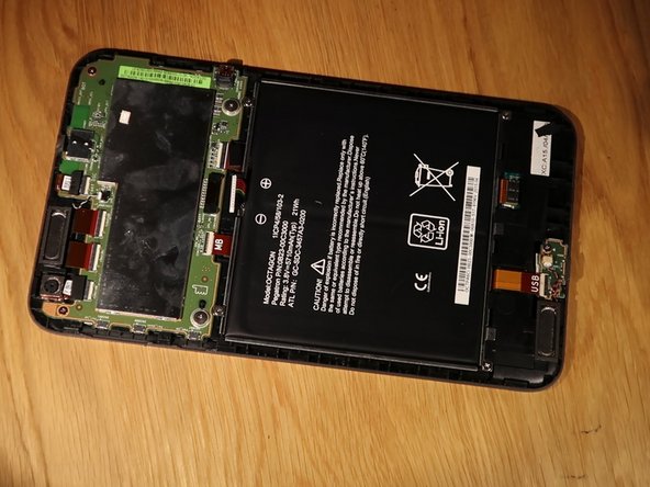

  2. Tesco hudl2 Charge port Replacement: crwdns2935265:02crwdnd2935265:01crwdnd2935265:01crwdne2935265:0
    • This is what you will see once the rear case is removed.

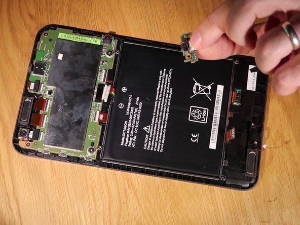

  3. Tesco hudl2 Charge port Replacement, Replace the charging port: crwdns2935265:03crwdnd2935265:01crwdnd2935265:03crwdne2935265:0 Tesco hudl2 Charge port Replacement, Replace the charging port: crwdns2935265:03crwdnd2935265:02crwdnd2935265:03crwdne2935265:0 Tesco hudl2 Charge port Replacement, Replace the charging port: crwdns2935265:03crwdnd2935265:03crwdnd2935265:03crwdne2935265:0
    • Carefully peel off the black sticky tape and set it aside.
    • Don't damage the twisted wire leading to the speaker.
    • Unscrew the two screws holding the port in place.
    • Remove the two pin speaker plug by moving it gently from side to side until it comes out of its socket.
    • Use a spudger to flip open the latch and then withdraw the flat cable.
    • Lift out the board and replace with a new one. Reattach the black sticky tape.
