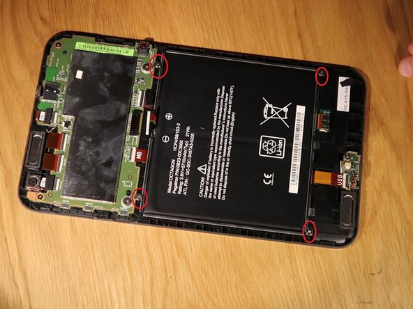

  2. Tesco hudl2 Battery Replacement: crwdns2935265:02crwdnd2935265:01crwdnd2935265:01crwdne2935265:0
    • This is what you will see once the rear case is removed.
  3. Tesco hudl2 Battery Replacement, Battery: crwdns2935265:03crwdnd2935265:01crwdnd2935265:03crwdne2935265:0 Tesco hudl2 Battery Replacement, Battery: crwdns2935265:03crwdnd2935265:02crwdnd2935265:03crwdne2935265:0 Tesco hudl2 Battery Replacement, Battery: crwdns2935265:03crwdnd2935265:03crwdnd2935265:03crwdne2935265:0
    • Unplug the old battery by gently rocking the white plug back and forth.
    • Unscrew the four screws holding the battery down.
    • Lift the battery out.
    • Put in the new battery, reinsert the plug and replace the four screws.
    • Test your tablet and make sure it's working normally and will take charge.
