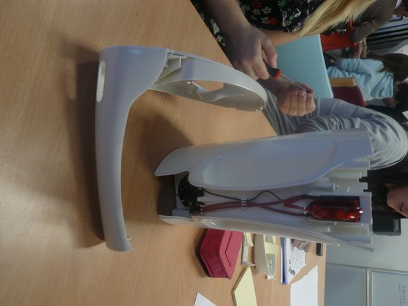

  4. Tesco Value JK07 Kettle Teardown: crwdns2935265:04crwdnd2935265:01crwdnd2935265:02crwdne2935265:0 Tesco Value JK07 Kettle Teardown: crwdns2935265:04crwdnd2935265:02crwdnd2935265:02crwdne2935265:0
    • Remove the screws on the underside of the kettle to release the socket cover.
    • Separate the handle from the kettle.

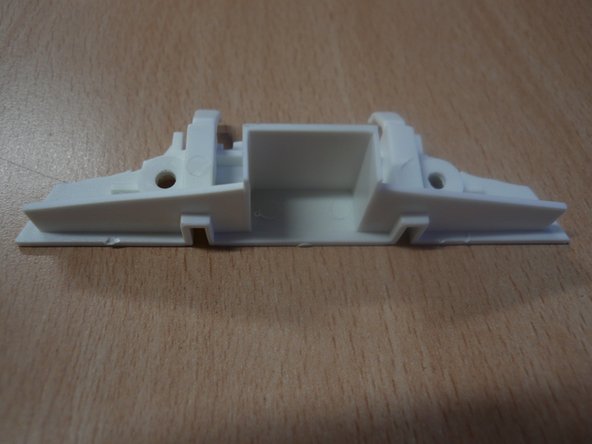

    • Gently remove the switch cover.
    • Remove the circular piece attached to the switch base by gently pulling it away.

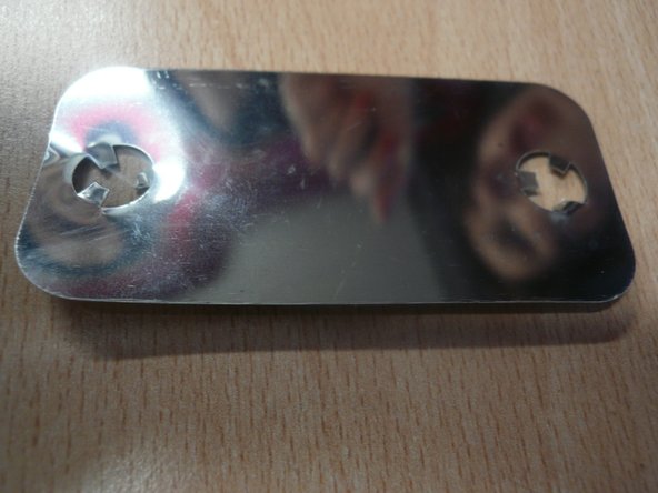

  8. Tesco Value JK07 Kettle Teardown: crwdns2935265:08crwdnd2935265:01crwdnd2935265:02crwdne2935265:0 Tesco Value JK07 Kettle Teardown: crwdns2935265:08crwdnd2935265:02crwdnd2935265:02crwdne2935265:0
    • Remove the heating element.
    • Remove the gasket.
    • Remove the plate beneath the heating element by bending the metal in the holes as shown in the picture. Remove the plate from the clips.
