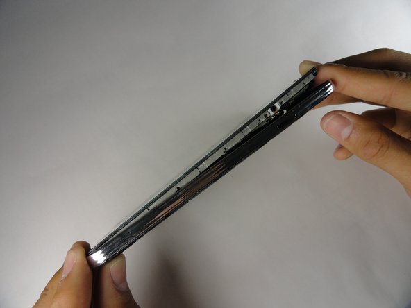

  5. Tengda S5 Plus Speakers Replacement: crwdns2935265:05crwdnd2935265:01crwdnd2935265:02crwdne2935265:0 Tengda S5 Plus Speakers Replacement: crwdns2935265:05crwdnd2935265:02crwdnd2935265:02crwdne2935265:0
    • Using the plastic opening tool, create space between the front screen and the metal casing.
    • Once the screen is separated from the back panel, pull the two pieces apart.

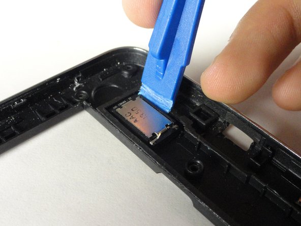

  6. Tengda S5 Plus Speakers Replacement: crwdns2935265:06crwdnd2935265:01crwdnd2935265:02crwdne2935265:0 Tengda S5 Plus Speakers Replacement: crwdns2935265:06crwdnd2935265:02crwdnd2935265:02crwdne2935265:0
    • Using an iFixit opening tool, remove the speakers.
    • Do not be afraid to use a little force. The speakers are glued onto the phone, not wired.
