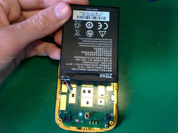

    • Disconnect the battery connector from the logic board. Do so by inserting a flat tool under the wires on the indicated side and wedging it up off the logic board.

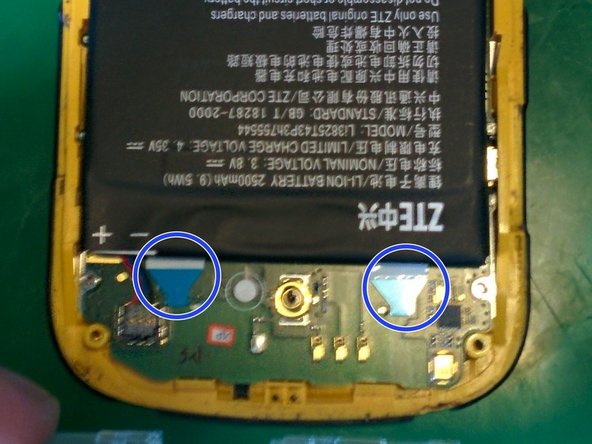

    • Then remove the double sided tape using the blue tabs provided. Simply grab a tab and pull until it comes out tweezers are really good for beginning the process.
    • These pull tabs will need to be replaced with double sided tape on reassembly.

how do you lift the battery with the blue tabs , its very hard to lift the battery i think i might have damaged the battery , it's kinda soft and not rigid like other phone batteries and stuck to the board ?
chrisorius - crwdns2934203:0crwdne2934203:0
Hi Chrisorius. You do not lift the battery with the tabs. The tabs are meant to be pulled so they come out from between the battery and the logic board. Then you should be able to lift the battery off the board with ease. Doesn't always work that way though, so have a pair of tweezers handy so you can grab the ends of the tabs to continue to pull them out. It is better to persevere with this than to lift your battery and damage it or your logic board.
Cheers Wayne
