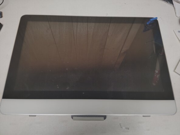

    • Lay the computer down on a flat surface
    • Put your suction cups on the top corners of the screen
    • Pull upwards in an arching motion trying to pull the front glass towards yourself. It's held in place with magnets, some force may be required.

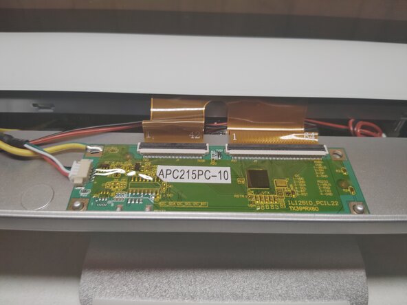

  2. Telikin Elite Silver 22in Touchscreen Computer, Front glass ribbon cable removal: crwdns2935265:02crwdnd2935265:01crwdnd2935265:01crwdne2935265:0
    • Disconnect the ribbon cables.
    • While wearing gloves remove the front glass and place it to the side

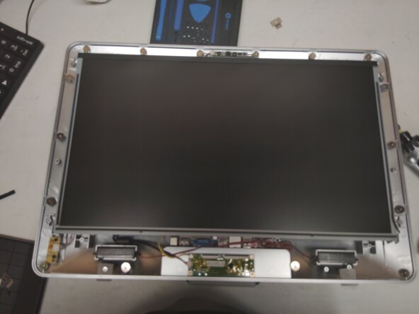

  3. Telikin Elite Silver 22in Touchscreen Computer, Screen bracket removal: crwdns2935265:03crwdnd2935265:01crwdnd2935265:01crwdne2935265:0
    • Remove the brackets on the top corners of the screen using a Phillips head screwdriver, put aside for reassembly.

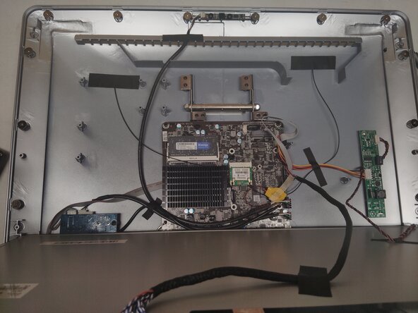

  4. Telikin Elite Silver 22in Touchscreen Computer, Moving the screen out of the way: crwdns2935265:04crwdnd2935265:01crwdnd2935265:01crwdne2935265:0
    • Once the screen is unscrewed pull in a similar arching motion as you did the front glass.

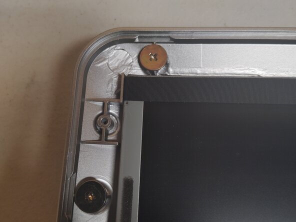

  5. Telikin Elite Silver 22in Touchscreen Computer, Reasembily tips: crwdns2935265:05crwdnd2935265:01crwdnd2935265:01crwdne2935265:0
    • When reassembling, ensure that the screen is flush with all four corners. Otherwise it will not seat back into the chassis properly.

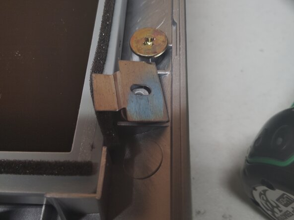

  6. Telikin Elite Silver 22in Touchscreen Computer: crwdns2935265:06crwdnd2935265:01crwdnd2935265:01crwdne2935265:0
    • This is the INCORRECT way to put the brackets back on, the bend point should be facing upwards
    • As some of the screws are next to the magnets, you may want to use a pair of pliers or tweezers to get them started in the holes
