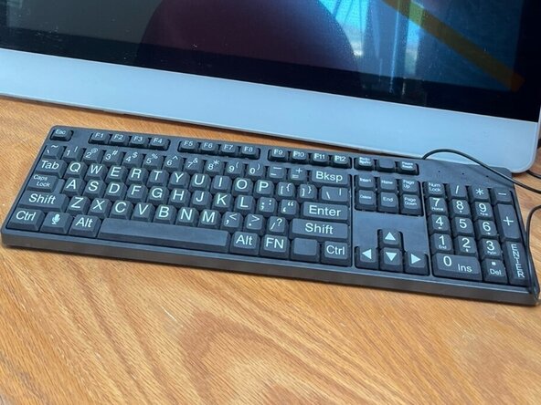

    • From this point you can now treat this like any traditional OS installation setting a external drive as the boot device
  7. Telikin Elite Silver 22in Technique enter bios, Note: crwdns2935265:011crwdnd2935265:01crwdnd2935265:01crwdne2935265:0
    • Do not use the included Telikin keyboard, when I did it I had to plug in a third party keyboard which is why its a required tool
