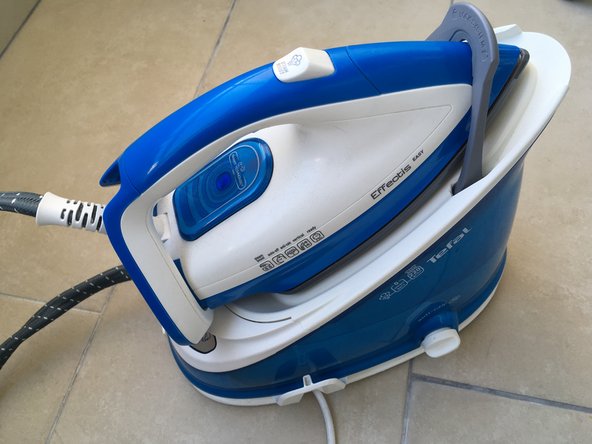

    • This is what we are going to teardown for repair. Other models of Tefal steam generator irons may have similar construction.

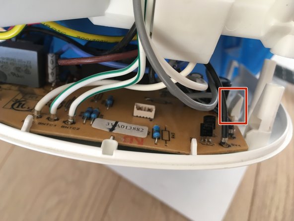

    • Remove the cable connector coming from the handle of the iron by pulling it up. Also remove the ground cable marked in the first photo.

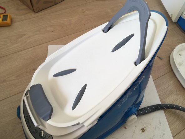

    • Locate two plastic tabs that hold the upper cover inside the plastic casing. Second and third photos show the openings that you can use to reach the tabs.

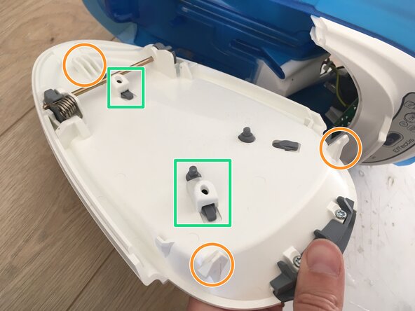

    • The second photo shows the bottom of the top cover. See the marked latching tabs on the top cover.
    • ATTENTION! In certain situations, there may be two additional screws that fix the top cover to the blue plastic base. These screws are underneath the rubber bumpers (marked with green squares on the second photo). I think the screws were added during a service in a case tabs were broken. This is a clever provision on Tefal's side for repairability.
