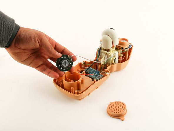

  10. Teddy Ruxpin Speaker Replacement, Housing Cover: crwdns2935265:010crwdnd2935265:01crwdnd2935265:03crwdne2935265:0 Teddy Ruxpin Speaker Replacement, Housing Cover: crwdns2935265:010crwdnd2935265:02crwdnd2935265:03crwdne2935265:0 Teddy Ruxpin Speaker Replacement, Housing Cover: crwdns2935265:010crwdnd2935265:03crwdnd2935265:03crwdne2935265:0
    • Unscrew the eleven circled 12.5mm Phillips #1 screws.
    • Remove the top of the housing to access the electronics inside.
  11. Teddy Ruxpin Speaker Replacement, Speaker: crwdns2935265:011crwdnd2935265:01crwdnd2935265:02crwdne2935265:0 Teddy Ruxpin Speaker Replacement, Speaker: crwdns2935265:011crwdnd2935265:02crwdnd2935265:02crwdne2935265:0
    • Unscrew the two 12.5mm Phillips #1 screws holding the speaker cap on and remove the speaker cap.
  12. Teddy Ruxpin Speaker Replacement: crwdns2935265:012crwdnd2935265:01crwdnd2935265:01crwdne2935265:0
    • Desolder the wire from the speaker and replace.
