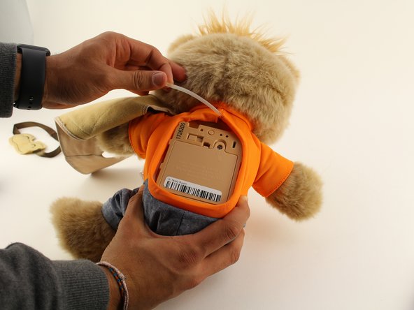

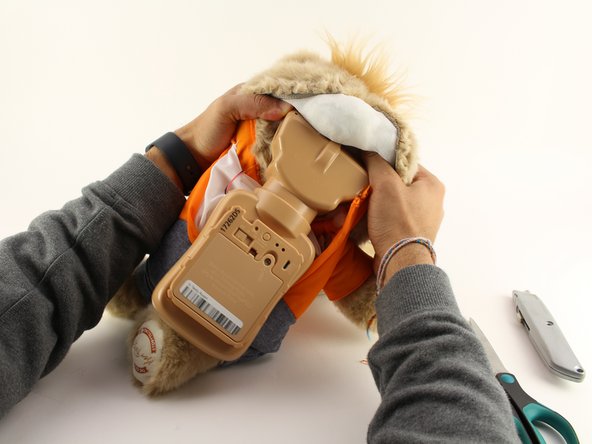

    • Remove the vest covering the back of the bear.
    • Orient the bear with his back facing upwards and unscrew the single Phillips #2 screw.
    • Captured screws will stay in place, no need to worry about losing this one!

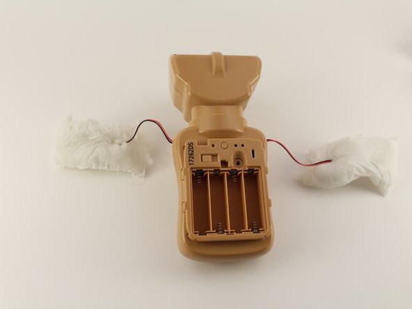

    • Pull the tab outward to remove the protective plate for the batteries.
  3. Teddy Ruxpin Motherboard Replacement: crwdns2935265:03crwdnd2935265:01crwdnd2935265:01crwdne2935265:0
    • Remove all four AA batteries by pushing the positive end down and pulling the battery out toward yourself.

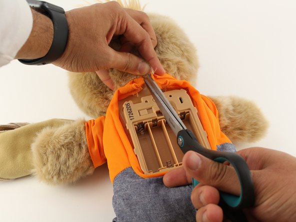

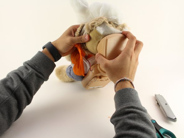

  4. Teddy Ruxpin Motherboard Replacement, Arms: crwdns2935265:04crwdnd2935265:01crwdnd2935265:03crwdne2935265:0 Teddy Ruxpin Motherboard Replacement, Arms: crwdns2935265:04crwdnd2935265:02crwdnd2935265:03crwdne2935265:0 Teddy Ruxpin Motherboard Replacement, Arms: crwdns2935265:04crwdnd2935265:03crwdnd2935265:03crwdne2935265:0
    • Cut the orange shirt and zip tie.
    • Remove the zip tie.
  5. Teddy Ruxpin Motherboard Replacement: crwdns2935265:05crwdnd2935265:01crwdnd2935265:01crwdne2935265:0
    • Cut across the back seam of the head of the bear along the arrow.
    • This damages the bear's exterior and will require resewing.

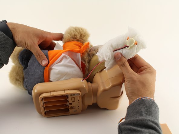

    • Unplug the arms from the main body.

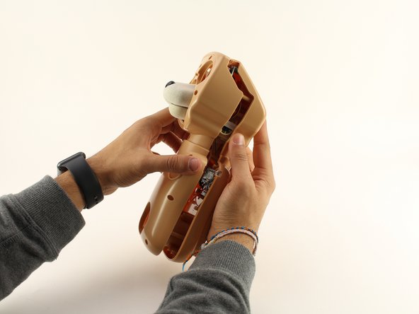

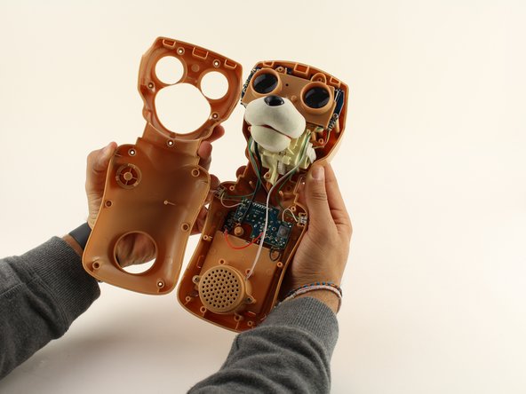

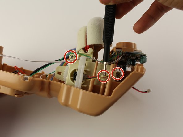

  10. Teddy Ruxpin Motherboard Replacement, Housing Cover: crwdns2935265:010crwdnd2935265:01crwdnd2935265:03crwdne2935265:0 Teddy Ruxpin Motherboard Replacement, Housing Cover: crwdns2935265:010crwdnd2935265:02crwdnd2935265:03crwdne2935265:0 Teddy Ruxpin Motherboard Replacement, Housing Cover: crwdns2935265:010crwdnd2935265:03crwdnd2935265:03crwdne2935265:0
    • Unscrew the eleven circled 12.5mm Phillips #1 screws.
    • Remove the top of the housing to access the electronics inside.

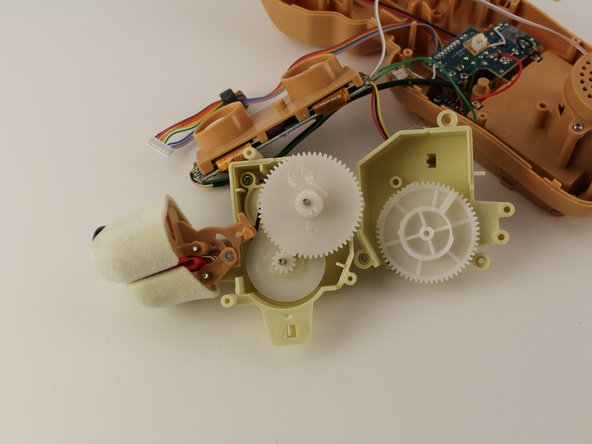

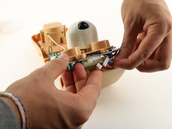

  16. Teddy Ruxpin Motherboard Replacement, Motherboard: crwdns2935265:016crwdnd2935265:01crwdnd2935265:01crwdne2935265:0
    • Remove the two 12.5 MM Phillips #1 screws holding the main motherboard into place.
  17. Teddy Ruxpin Motherboard Replacement: crwdns2935265:017crwdnd2935265:01crwdnd2935265:01crwdne2935265:0
    • Desolder all connections.
