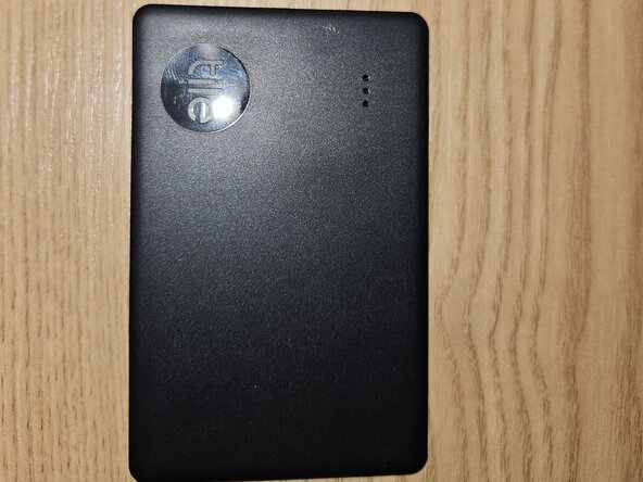

  1. Teardown Tile Slim (2022), Teardown Tile Slim (2022): crwdns2935265:01crwdnd2935265:01crwdnd2935265:03crwdne2935265:0 Teardown Tile Slim (2022), Teardown Tile Slim (2022): crwdns2935265:01crwdnd2935265:02crwdnd2935265:03crwdne2935265:0 Teardown Tile Slim (2022), Teardown Tile Slim (2022): crwdns2935265:01crwdnd2935265:03crwdnd2935265:03crwdne2935265:0

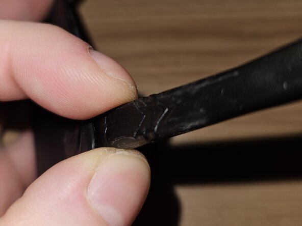

    • Lay down the slim tracker on a flat surface with the button upward.
    • Use a "Spudger" on the corner, where the button is nearest, to carefuly pry the casing open. This will just be a entry-Point, so there is no rush.

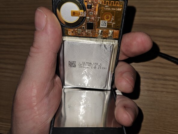

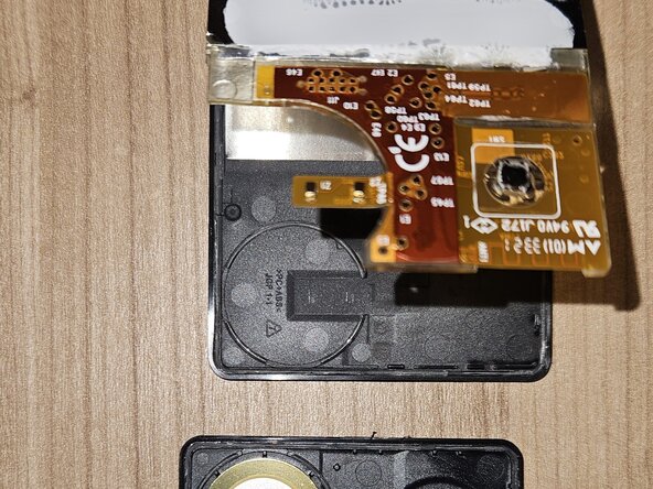

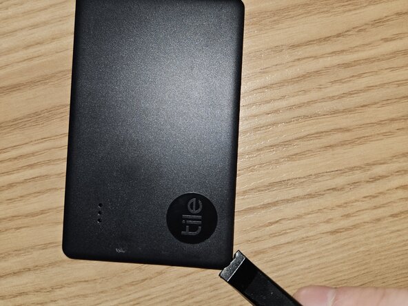

  2. Teardown Tile Slim (2022): crwdns2935265:02crwdnd2935265:01crwdnd2935265:03crwdne2935265:0 Teardown Tile Slim (2022): crwdns2935265:02crwdnd2935265:02crwdnd2935265:03crwdne2935265:0 Teardown Tile Slim (2022): crwdns2935265:02crwdnd2935265:03crwdnd2935265:03crwdne2935265:0
    • Follow the Edges from here with the "Spudger" to resume prying, until both plastic sides are seperated.

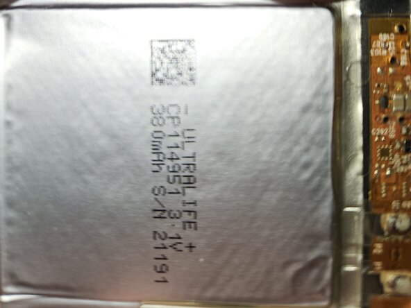

    • You can see a flat, !bendable! battery, the speaker on the plastic-half and the circuit board.
    • There is Aluminium-Foil glued down to both sides of the plastic sheets half's. Its smell (Glue?) is quite extreme, almost like a battery leakage in my case.

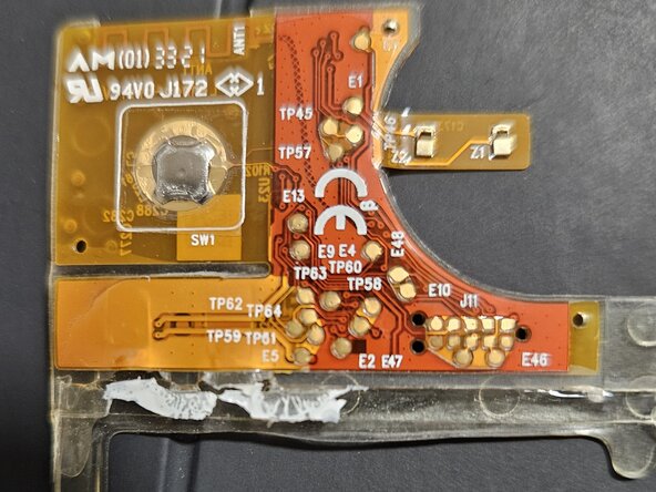

  3. Teardown Tile Slim (2022): crwdns2935265:03crwdnd2935265:01crwdnd2935265:02crwdne2935265:0 Teardown Tile Slim (2022): crwdns2935265:03crwdnd2935265:02crwdnd2935265:02crwdne2935265:0
    • There is a transparent holder between circuit and battery at the edge of the whole battery, yet the contacts seem to be soldered on the same.
