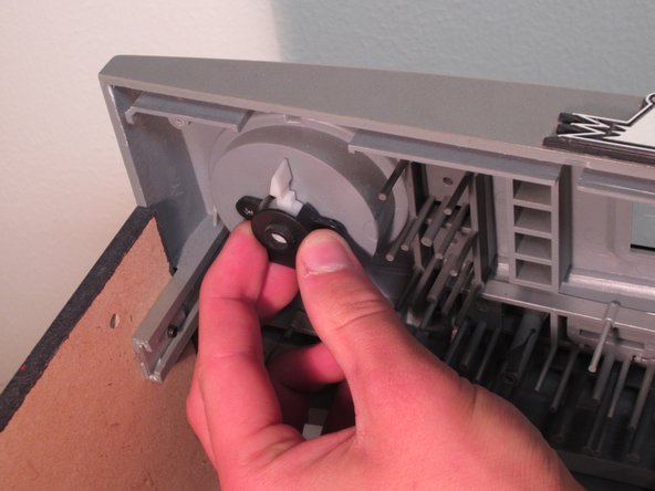

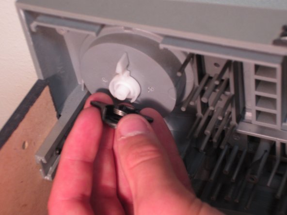

    • Remove the screws and the black piece that are holding the volume control knob in place.
  4. Teac DC-D2831 volume control knob replacement: crwdns2935265:04crwdnd2935265:01crwdnd2935265:02crwdne2935265:0 Teac DC-D2831 volume control knob replacement: crwdns2935265:04crwdnd2935265:02crwdnd2935265:02crwdne2935265:0

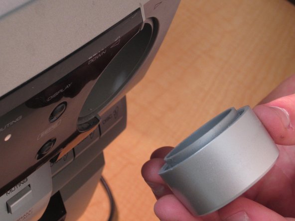

    • Pull the volume control knob from the outside and the white piece on the inside until they separate.
    • Replace the volume knob with a new one to complete the repair.
