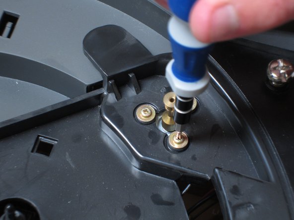

    • Remove the three brass screws using a phillips #1 screwdriver.

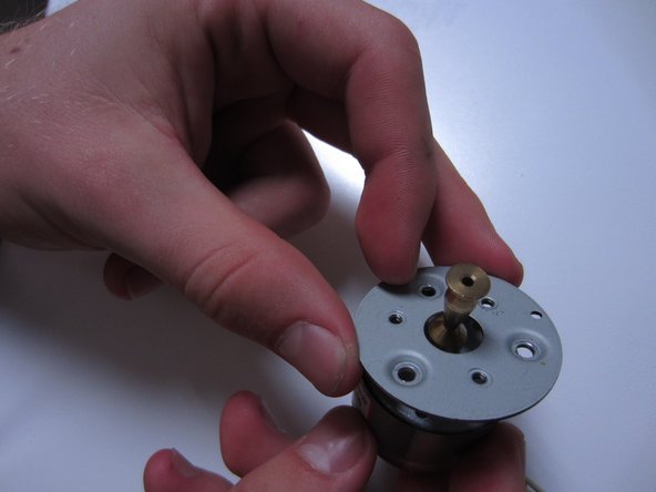

  3. Teac DC-D2831 Motor Replacement: crwdns2935265:03crwdnd2935265:01crwdnd2935265:03crwdne2935265:0 Teac DC-D2831 Motor Replacement: crwdns2935265:03crwdnd2935265:02crwdnd2935265:03crwdne2935265:0 Teac DC-D2831 Motor Replacement: crwdns2935265:03crwdnd2935265:03crwdnd2935265:03crwdne2935265:0
    • Using the phillips #1 screwdriver, remove the three screws that are holding the circular mounting bracket to the motor.
    • Remove the circular mounting bracket from the motor.

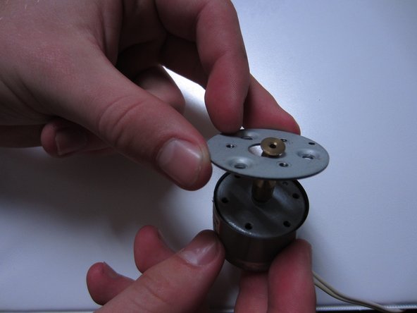

  4. Teac DC-D2831 Motor Replacement: crwdns2935265:04crwdnd2935265:01crwdnd2935265:02crwdne2935265:0 Teac DC-D2831 Motor Replacement: crwdns2935265:04crwdnd2935265:02crwdnd2935265:02crwdne2935265:0
    • Attach the mounting bracket to the new motor.
    • Insert the new motor.
    • Flip the turntable over making sure the motor stays in place, and insert the screws underneath the turntable.
