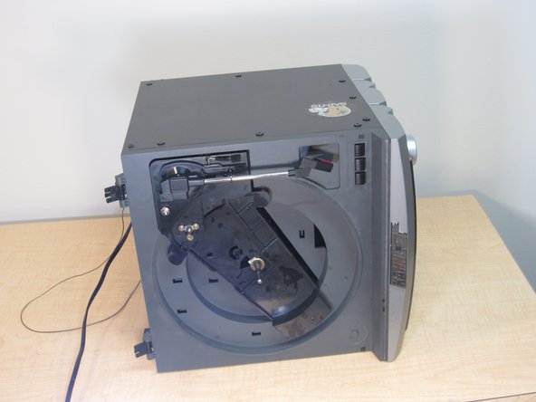

    • Once the belt is ready to go, re-wrap the belt around the turntable wheel and, keeping it around the wheel, wrap it around the motor (indicated by the red circle).
    • It may be helpful to lay the record player on its side to keep the belt wrapped around both the motor and the turntable wheel.
  4. Teac DC-D2831 Drive Belt replacement: crwdns2935265:04crwdnd2935265:01crwdnd2935265:01crwdne2935265:0
    • Once the belt has been re-applied and the turntable re-attached, stand the record player back up.
