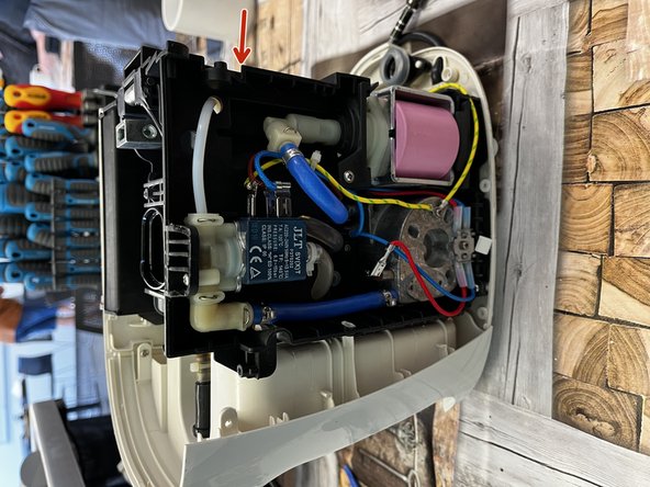

  7. Tchibo Cafissimo Mini 313212 water tank sensor repair, Sensor identification: crwdns2935265:07crwdnd2935265:01crwdnd2935265:03crwdne2935265:0 Tchibo Cafissimo Mini 313212 water tank sensor repair, Sensor identification: crwdns2935265:07crwdnd2935265:02crwdnd2935265:03crwdne2935265:0 Tchibo Cafissimo Mini 313212 water tank sensor repair, Sensor identification: crwdns2935265:07crwdnd2935265:03crwdnd2935265:03crwdne2935265:0
    • Sensor identification
    • Location: back of the device on the right side in a holder

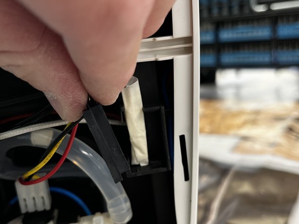

  8. Tchibo Cafissimo Mini 313212 water tank sensor repair, Reposition the sensor in the holder: crwdns2935265:08crwdnd2935265:01crwdnd2935265:03crwdne2935265:0 Tchibo Cafissimo Mini 313212 water tank sensor repair, Reposition the sensor in the holder: crwdns2935265:08crwdnd2935265:02crwdnd2935265:03crwdne2935265:0 Tchibo Cafissimo Mini 313212 water tank sensor repair, Reposition the sensor in the holder: crwdns2935265:08crwdnd2935265:03crwdnd2935265:03crwdne2935265:0
    • Remove the sensor from the holder
    • Roll up several centimeters of masking tape to the width of the sensor
    • Apply masking tape behind the sensor in the bracket
    • Install the sensor (sensor will sit 1-2 mm closer to plastic trim)

There is a one important missing step before runing a spudger around the lid to loosen the clips.
there is one additional screw under the red (Max )button , you need to remove the selecon lid cover unscrew this last one before trying to remove the Lid

Ich danke dir vielmals!!! Habs genau nach deiner Anleitung gemacht. Und die Maschine funktioniert wieder. Es lag tatsächlich am inneren Magneten. Hast mich vor dem Kauf eines neuen Gerätes bewahrt.
Billie - crwdns2934203:0crwdne2934203:0
Ačiū už idėją. Man nepadėjo 1mm. Išpjoviau korpuse langą ir sensorius dabar lygiai su korpusu. Dabar veikia. Problema silpnas magnetas vandens bake.
