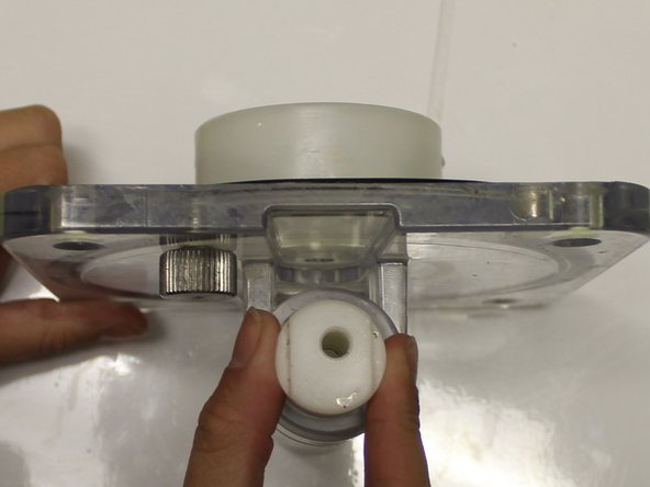

  8. Taylor 342D-27 O-Ring  Replacement: crwdns2935265:08crwdnd2935265:01crwdnd2935265:01crwdne2935265:0
    • Push the valve up using your thumb to remove. Once there is enough of the valve out of the top of the door to hold on to, pull it out.

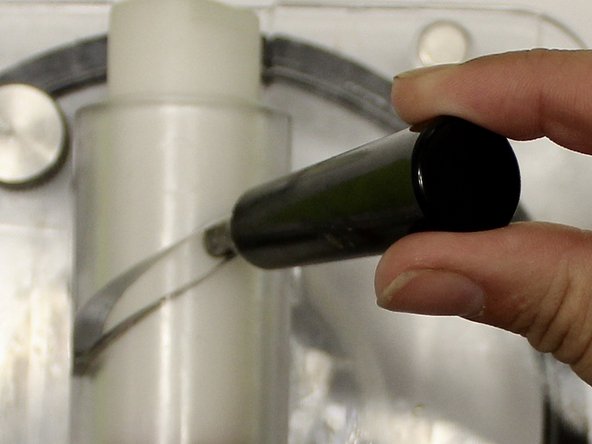

    • Take off the broken o-ring using the o-ring removal tool. To remove, place the end of the removal tool under the o-ring and bring it out the other side.
    • If the o-ring has snapped and is not longer intact, you can use your fingers to remove the broken pieces.

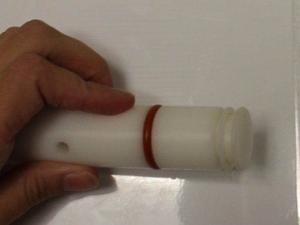

  10. Taylor 342D-27 O-Ring  Replacement: crwdns2935265:010crwdnd2935265:01crwdnd2935265:01crwdne2935265:0
    • Put a new, well lubed, o-ring back on the valve. The o-ring removal tool can be used in this step or just using pressure with your hands.
