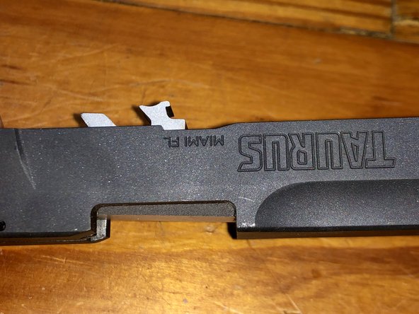

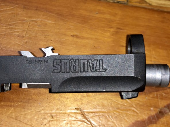

  3. Taurus G2C Field Strip Disassembly, Separating the slide and the grip: crwdns2935265:03crwdnd2935265:01crwdnd2935265:03crwdne2935265:0 Taurus G2C Field Strip Disassembly, Separating the slide and the grip: crwdns2935265:03crwdnd2935265:02crwdnd2935265:03crwdne2935265:0 Taurus G2C Field Strip Disassembly, Separating the slide and the grip: crwdns2935265:03crwdnd2935265:03crwdnd2935265:03crwdne2935265:0
    • Continue moving the slide forwards until the rear of the slide passes the guides the notches above the disassembly latches(pointed out in the last picture).

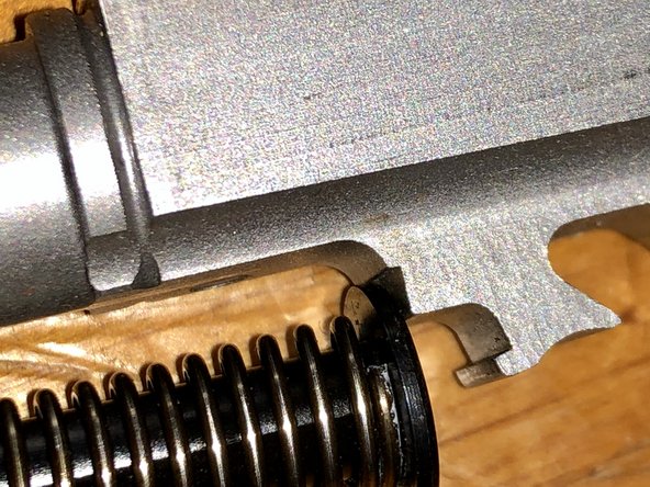

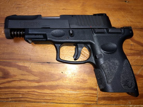

  4. Taurus G2C Field Strip Disassembly, Removing the recoil spring assembly: crwdns2935265:04crwdnd2935265:01crwdnd2935265:03crwdne2935265:0 Taurus G2C Field Strip Disassembly, Removing the recoil spring assembly: crwdns2935265:04crwdnd2935265:02crwdnd2935265:03crwdne2935265:0 Taurus G2C Field Strip Disassembly, Removing the recoil spring assembly: crwdns2935265:04crwdnd2935265:03crwdnd2935265:03crwdne2935265:0
    • The recoil spring assembly is on the bottom of the barrel. It is held in place by the spring's own tension against a notch in the barrel (2nd picture) and its slot in the end of the slide.
    • While holding the slide with the muzzle pointing away from you, put your thumb or index finger on the rear-facing portion of the recoil spring assembly. Push the assembly forward to free it from the tension against the barrel, then release the tension and pull it out of its slot in the slide.

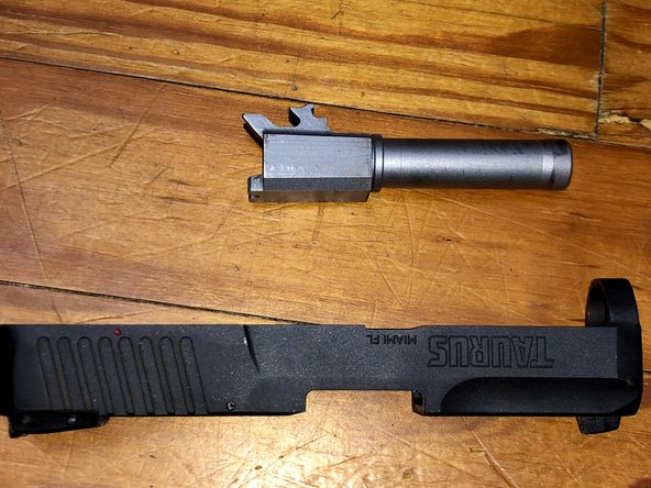

  5. Taurus G2C Field Strip Disassembly, Removing the barrel: crwdns2935265:05crwdnd2935265:01crwdnd2935265:03crwdne2935265:0 Taurus G2C Field Strip Disassembly, Removing the barrel: crwdns2935265:05crwdnd2935265:02crwdnd2935265:03crwdne2935265:0 Taurus G2C Field Strip Disassembly, Removing the barrel: crwdns2935265:05crwdnd2935265:03crwdnd2935265:03crwdne2935265:0
    • With the recoil spring assembly no longer holding the barrel in, the barrel can now be removed.
    • Move the barrel slightly towards the bottom of the slide
    • Push the barrel forward a little bit to allow enough space to clear the ejector (not pictured)
  6. Taurus G2C Field Strip Disassembly: crwdns2935265:06crwdnd2935265:01crwdnd2935265:02crwdne2935265:0 Taurus G2C Field Strip Disassembly: crwdns2935265:06crwdnd2935265:02crwdnd2935265:02crwdne2935265:0
    • Lift the barrel out of the slide.
