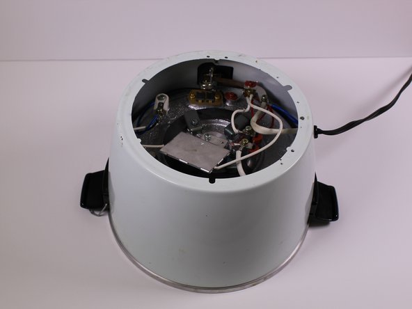

  5. Tatung TAC-6G Light Element Replacement: crwdns2935265:05crwdnd2935265:01crwdnd2935265:01crwdne2935265:0
    • Flip the rice cooker device upside down.
  6. Tatung TAC-6G Light Element Replacement: crwdns2935265:06crwdnd2935265:01crwdnd2935265:02crwdne2935265:0 Tatung TAC-6G Light Element Replacement: crwdns2935265:06crwdnd2935265:02crwdnd2935265:02crwdne2935265:0
    • Remove the one 7mm Phillips screw from the side of the brass panel
    • Lift the brass plate off of the device and set it aside.
  7. Tatung TAC-6G Light Element Replacement: crwdns2935265:07crwdnd2935265:01crwdnd2935265:01crwdne2935265:0
    • Remove the 7mm Phillips screw holding the white and maroon colored wires that are connected to the heating element.
  8. Tatung TAC-6G Light Element Replacement: crwdns2935265:08crwdnd2935265:01crwdnd2935265:01crwdne2935265:0
    • Remove the 10mm Phillips screw that connects the white, blue and black wires to the white plastic piece in the corner of the device.
  9. Tatung TAC-6G Light Element Replacement: crwdns2935265:09crwdnd2935265:01crwdnd2935265:01crwdne2935265:0
    • Remove the 7mm Phillips screw that connects two white wires and one red wire to the heating "warm" switch.
  10. Tatung TAC-6G Light Element Replacement: crwdns2935265:010crwdnd2935265:01crwdnd2935265:01crwdne2935265:0
    • Using your hand, pull out the light plate with the maroon red and black wires.
  11. Tatung TAC-6G Light Element Replacement: crwdns2935265:011crwdnd2935265:01crwdnd2935265:01crwdne2935265:0
    • Replace the light plate dashboard.

Reverse the steps for reassembly.
