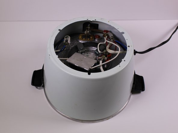

    • Lift the lid and bowl from top of the device
    • Be sure device is not plugged in before beginning replacement of heating element
  2. Tatung TAC-6G Heating Element Replacement: crwdns2935265:02crwdnd2935265:01crwdnd2935265:01crwdne2935265:0
    • Turn the bowl upside down so that the three legs point upwards

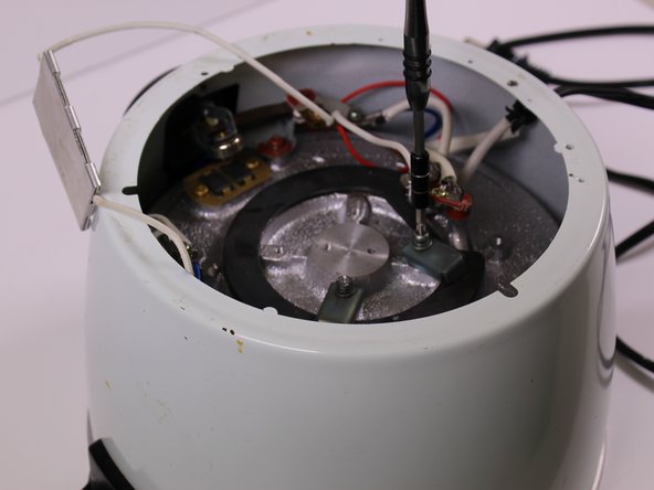

  3. Tatung TAC-6G Heating Element Replacement: crwdns2935265:03crwdnd2935265:01crwdnd2935265:02crwdne2935265:0 Tatung TAC-6G Heating Element Replacement: crwdns2935265:03crwdnd2935265:02crwdnd2935265:02crwdne2935265:0
    • Remove the one 7 mm Phillips screw from the side of the brass panel.
  4. Tatung TAC-6G Heating Element Replacement: crwdns2935265:04crwdnd2935265:01crwdnd2935265:02crwdne2935265:0 Tatung TAC-6G Heating Element Replacement: crwdns2935265:04crwdnd2935265:02crwdnd2935265:02crwdne2935265:0
    • Remove the 6mm Phillips screw that holds the stainless plate.
  5. Tatung TAC-6G Heating Element Replacement: crwdns2935265:05crwdnd2935265:01crwdnd2935265:03crwdne2935265:0 Tatung TAC-6G Heating Element Replacement: crwdns2935265:05crwdnd2935265:02crwdnd2935265:03crwdne2935265:0 Tatung TAC-6G Heating Element Replacement: crwdns2935265:05crwdnd2935265:03crwdnd2935265:03crwdne2935265:0
    • Remove all four of the 15mm Phillips screws from all four of the brackets that hold the heating element in place
  6. Tatung TAC-6G Heating Element Replacement: crwdns2935265:06crwdnd2935265:01crwdnd2935265:01crwdne2935265:0
    • Using your hands, remove the heating plate that is on top of heating element.
  7. Tatung TAC-6G Heating Element Replacement: crwdns2935265:07crwdnd2935265:01crwdnd2935265:01crwdne2935265:0
    • Remove the 7mm Phillips screw that holds the white wire connected to the heating element.
  8. Tatung TAC-6G Heating Element Replacement: crwdns2935265:08crwdnd2935265:01crwdnd2935265:01crwdne2935265:0
    • Remove the 7mm Phillips screw that holds the white & maroon wires connected to the heating element.
  9. Tatung TAC-6G Heating Element Replacement: crwdns2935265:09crwdnd2935265:01crwdnd2935265:01crwdne2935265:0
    • Using, your hands, take out the heating element and replace it with a new one.
