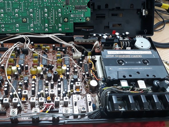

    • Remove the power buton
    • Remove the screws from back
    • Gently open the device
  2. Tascam Portastudio 05 Broken Play Switch: crwdns2935265:02crwdnd2935265:01crwdnd2935265:03crwdne2935265:0 Tascam Portastudio 05 Broken Play Switch: crwdns2935265:02crwdnd2935265:02crwdnd2935265:03crwdne2935265:0 Tascam Portastudio 05 Broken Play Switch: crwdns2935265:02crwdnd2935265:03crwdnd2935265:03crwdne2935265:0
    • Remove this screws
    • The PLAY doesn't work because the plastic is broken. It holds a spring.
    • Gluing the plastic will not work, as spring pressure is too high.
  3. Tascam Portastudio 05 Broken Play Switch: crwdns2935265:03crwdnd2935265:01crwdnd2935265:03crwdne2935265:0 Tascam Portastudio 05 Broken Play Switch: crwdns2935265:03crwdnd2935265:02crwdnd2935265:03crwdne2935265:0 Tascam Portastudio 05 Broken Play Switch: crwdns2935265:03crwdnd2935265:03crwdnd2935265:03crwdne2935265:0
    • To make a good support for the spring, drill a hole on the metal and ADD a little screw.
  4. Tascam Portastudio 05 Broken Play Switch: crwdns2935265:04crwdnd2935265:01crwdnd2935265:02crwdne2935265:0 Tascam Portastudio 05 Broken Play Switch: crwdns2935265:04crwdnd2935265:02crwdnd2935265:02crwdne2935265:0

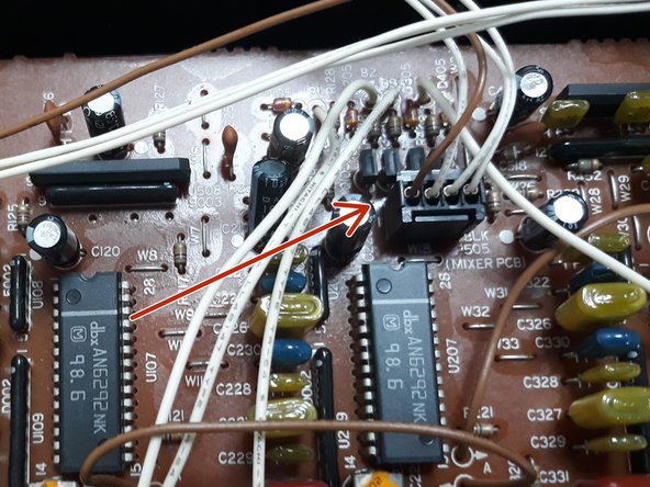

    • This little plug has the sound output of the four tracks split. You can add independent outputs from tape.
