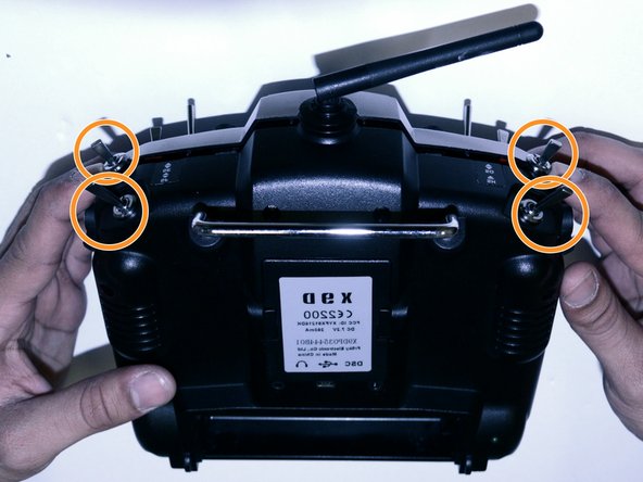

    • Remove the eight screws holding the gimbals to the front of the case using a 2.5 mm Hex key.
    • Push all switches forward or away from you (this will be important for reassembly).

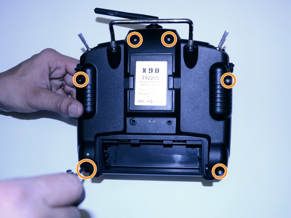

    • Remove six screws from the back of the device using a Phillips #0 screwdriver.
    • Ensure the switches are in the position from the previous step, as they are not held in place and can reverse direction.

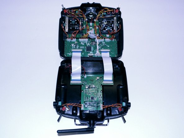

    • Gently pull the back up and open the radio in the form of a book, with the battery compartment being the spine.
    • Lay the controller on its front so that as the last screw is removed, the two halves don't fall apart.

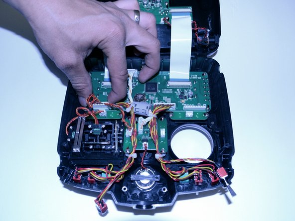

    • Detach a total of six connectors (three per gimbal).
    • Pull the gimbals out from the radio frame.

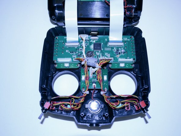

  5. Taranis X9D & X9D Plus Hall Effect Gimbals Replacement: crwdns2935265:05crwdnd2935265:01crwdnd2935265:02crwdne2935265:0 Taranis X9D & X9D Plus Hall Effect Gimbals Replacement: crwdns2935265:05crwdnd2935265:02crwdnd2935265:02crwdne2935265:0
    • New gimbals come in left and right boxes, respectively, so as not to mix them up, as well as identical connections for a drop-in replacement.
    • New gimbals will include new hex bolts for the front, as the stock ones will not fit.
    • When dropping the new gimbals into place, the harnesses will face downwards on their respective side.
    • Do not press on the cables. Push down on the connectors with your thumbs.
