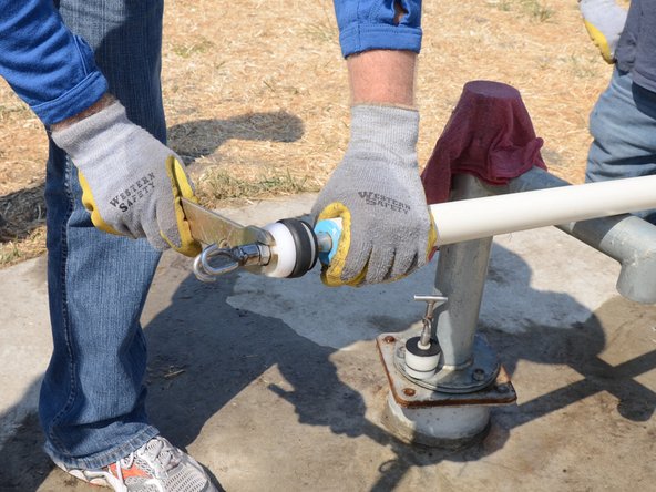

  20. Tara Traveling Valve Replacement: crwdns2935265:020crwdnd2935265:01crwdnd2935265:03crwdne2935265:0 Tara Traveling Valve Replacement: crwdns2935265:020crwdnd2935265:02crwdnd2935265:03crwdne2935265:0 Tara Traveling Valve Replacement: crwdns2935265:020crwdnd2935265:03crwdnd2935265:03crwdne2935265:0
    • The last section of riser main will have the traveling valve screwed on to the end, and the foot valve hooked onto the traveling valve.
    • Be careful not to allow the foot valve to release from the hook by pulling slowly on the riser main.
  21. Tara Traveling Valve Replacement: crwdns2935265:021crwdnd2935265:01crwdnd2935265:03crwdne2935265:0 Tara Traveling Valve Replacement: crwdns2935265:021crwdnd2935265:02crwdnd2935265:03crwdne2935265:0 Tara Traveling Valve Replacement: crwdns2935265:021crwdnd2935265:03crwdnd2935265:03crwdne2935265:0
    • Lift and twist the foot valve to unhook it from the traveling valve.

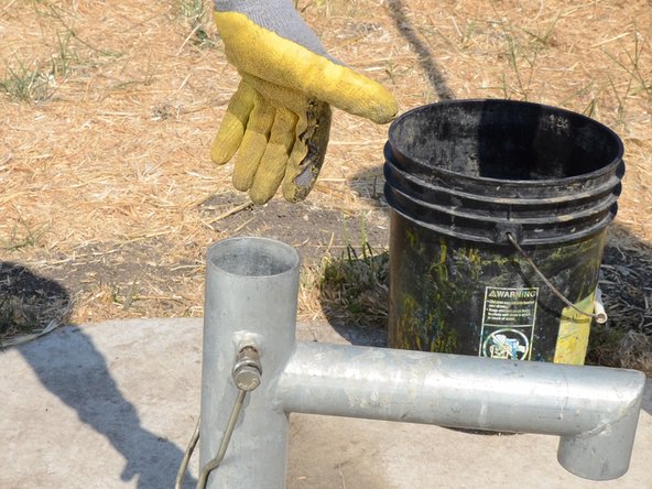

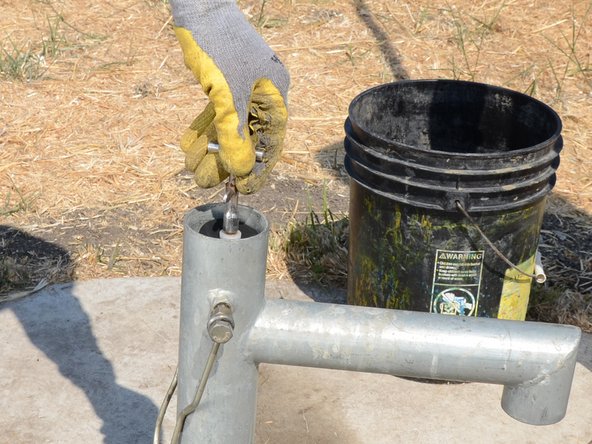

  22. Tara Traveling Valve Replacement: crwdns2935265:022crwdnd2935265:01crwdnd2935265:01crwdne2935265:0
    • Once the riser main and valves have been removed from the well, place a rag over the top to prevent accidentally dropping anything down the well.

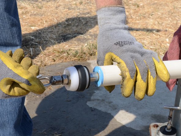

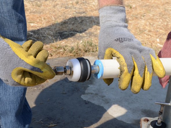

  23. Tara Traveling Valve Replacement, Traveling Valve: crwdns2935265:023crwdnd2935265:01crwdnd2935265:02crwdne2935265:0 Tara Traveling Valve Replacement, Traveling Valve: crwdns2935265:023crwdnd2935265:02crwdnd2935265:02crwdne2935265:0
    • While holding onto the pump rod, use a Tara tool to loosen the jam nut from the hook.
  24. Tara Traveling Valve Replacement: crwdns2935265:024crwdnd2935265:01crwdnd2935265:03crwdne2935265:0 Tara Traveling Valve Replacement: crwdns2935265:024crwdnd2935265:02crwdnd2935265:03crwdne2935265:0 Tara Traveling Valve Replacement: crwdns2935265:024crwdnd2935265:03crwdnd2935265:03crwdne2935265:0
    • Unscrew and remove the hook from the base of the pump rod.

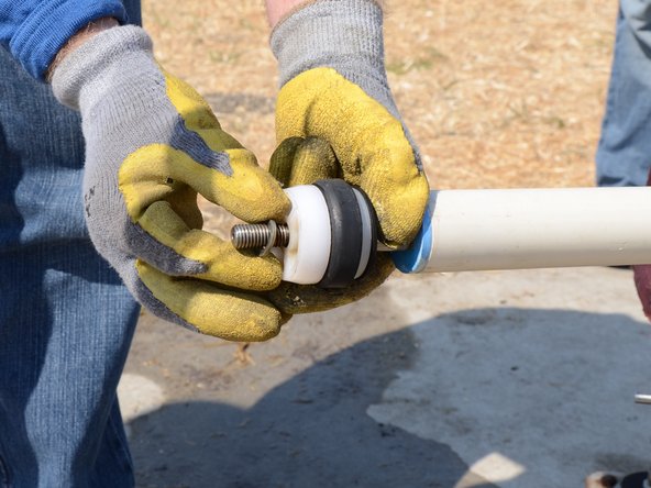

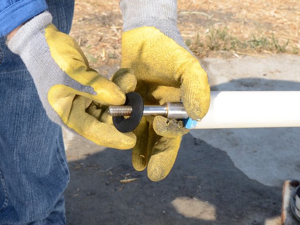

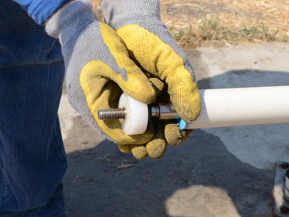

  25. Tara Traveling Valve Replacement: crwdns2935265:025crwdnd2935265:01crwdnd2935265:03crwdne2935265:0 Tara Traveling Valve Replacement: crwdns2935265:025crwdnd2935265:02crwdnd2935265:03crwdne2935265:0 Tara Traveling Valve Replacement: crwdns2935265:025crwdnd2935265:03crwdnd2935265:03crwdne2935265:0
    • Remove the jam nut from the base of the pump rod.
    • Remove the washer.
    • Remove the traveling valve components.
  26. Tara Traveling Valve Replacement: crwdns2935265:026crwdnd2935265:01crwdnd2935265:03crwdne2935265:0 Tara Traveling Valve Replacement: crwdns2935265:026crwdnd2935265:02crwdnd2935265:03crwdne2935265:0 Tara Traveling Valve Replacement: crwdns2935265:026crwdnd2935265:03crwdnd2935265:03crwdne2935265:0
    • Check all components for signs of wear or damage.
  27. Tara Traveling Valve Replacement: crwdns2935265:027crwdnd2935265:01crwdnd2935265:03crwdne2935265:0 Tara Traveling Valve Replacement: crwdns2935265:027crwdnd2935265:02crwdnd2935265:03crwdne2935265:0 Tara Traveling Valve Replacement: crwdns2935265:027crwdnd2935265:03crwdnd2935265:03crwdne2935265:0
    • When reassembling the pump, drop the foot valve down the well in the proper orientation, and follow the directions in reverse.
