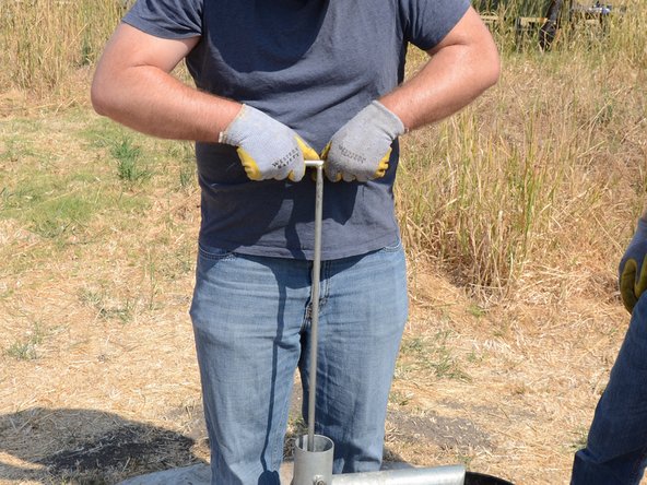

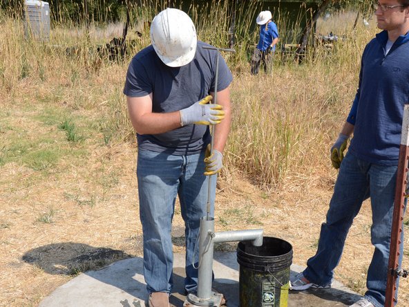

    • Before performing any repairs, perform a water test on the pump by raising and lowering the handle a full 40 strokes. A properly performing pump will yield greater than 10 liters.
    • Use a Tara tool to loosen the jam nuts on either side of the pump.
    • The bolts do not need to be loosened or removed, only the nuts need to be loosened.
  2. Tara Foot Valve Replacement: crwdns2935265:02crwdnd2935265:01crwdnd2935265:03crwdne2935265:0 Tara Foot Valve Replacement: crwdns2935265:02crwdnd2935265:02crwdnd2935265:03crwdne2935265:0 Tara Foot Valve Replacement: crwdns2935265:02crwdnd2935265:03crwdnd2935265:03crwdne2935265:0

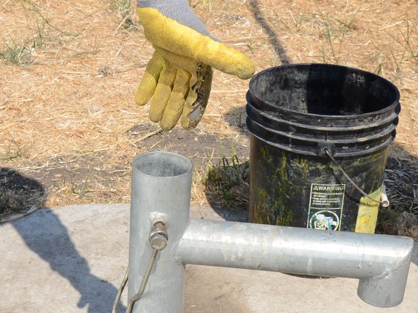

    • Unscrew the lock bolts about half an inch.
    • The bolts do not need to be removed from the base.
  3. Tara Foot Valve Replacement: crwdns2935265:03crwdnd2935265:01crwdnd2935265:02crwdne2935265:0 Tara Foot Valve Replacement: crwdns2935265:03crwdnd2935265:02crwdnd2935265:02crwdne2935265:0

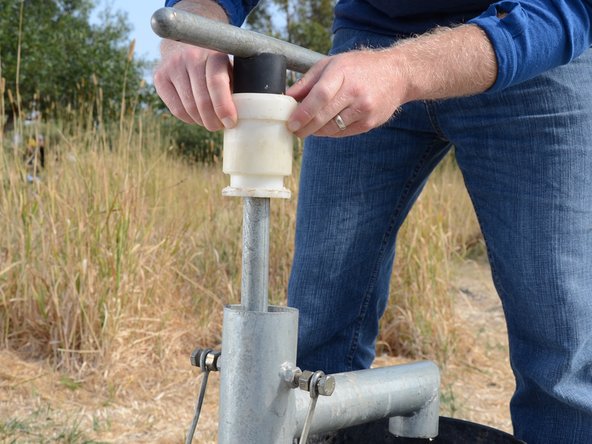

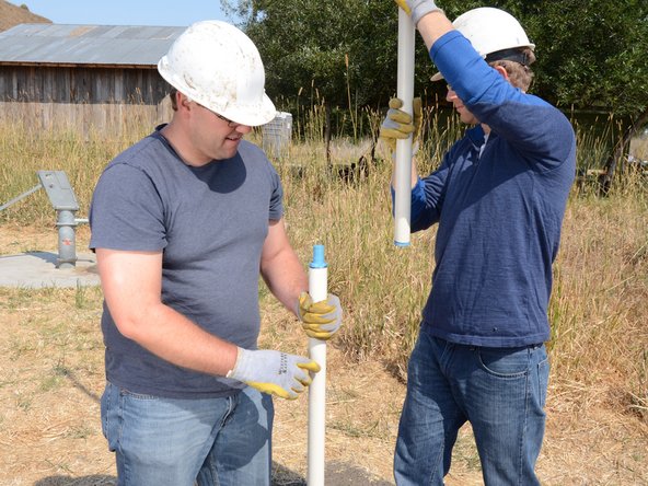

    • Pull the plastic bushing and handle straight up out of the pump.
    • If the bushing doesn't come up, loosen the lock bolts further.

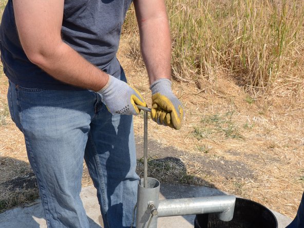

  4. Tara Foot Valve Replacement: crwdns2935265:04crwdnd2935265:01crwdnd2935265:02crwdne2935265:0 Tara Foot Valve Replacement: crwdns2935265:04crwdnd2935265:02crwdnd2935265:02crwdne2935265:0

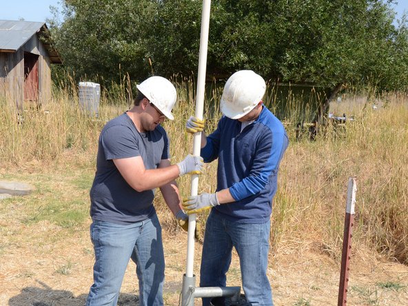

    • Lift up the handle and riser main until the joint between the two is at a comfortable height to work on.
  5. Tara Foot Valve Replacement: crwdns2935265:05crwdnd2935265:01crwdnd2935265:03crwdne2935265:0 Tara Foot Valve Replacement: crwdns2935265:05crwdnd2935265:02crwdnd2935265:03crwdne2935265:0 Tara Foot Valve Replacement: crwdns2935265:05crwdnd2935265:03crwdnd2935265:03crwdne2935265:0

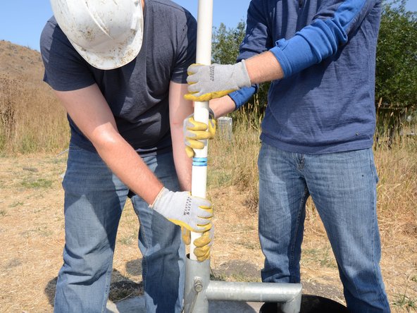

    • Loosen the jam nut beneath the pump handle using the Tara tool.
  6. Tara Foot Valve Replacement: crwdns2935265:06crwdnd2935265:01crwdnd2935265:02crwdne2935265:0 Tara Foot Valve Replacement: crwdns2935265:06crwdnd2935265:02crwdnd2935265:02crwdne2935265:0

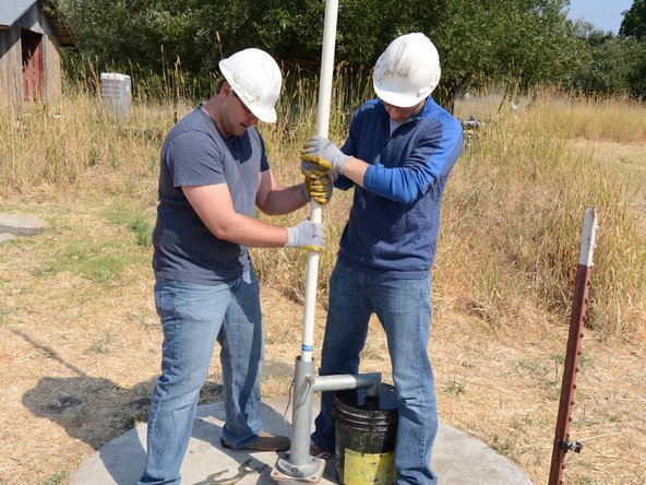

    • Unscrew the pump handle from the top of the riser main.
    • Make sure someone is tightly holding the lower portion of the riser main to prevent losing it down the well.
  7. Tara Foot Valve Replacement: crwdns2935265:07crwdnd2935265:01crwdnd2935265:02crwdne2935265:0 Tara Foot Valve Replacement: crwdns2935265:07crwdnd2935265:02crwdnd2935265:02crwdne2935265:0
    • Lift and remove the handle from the pump. Store the handle in a sanitary place to prevent contamination.

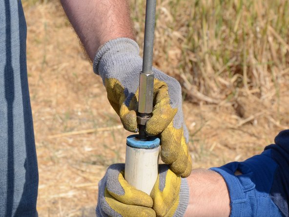

  8. Tara Foot Valve Replacement, Pump Rod: crwdns2935265:08crwdnd2935265:01crwdnd2935265:03crwdne2935265:0 Tara Foot Valve Replacement, Pump Rod: crwdns2935265:08crwdnd2935265:02crwdnd2935265:03crwdne2935265:0 Tara Foot Valve Replacement, Pump Rod: crwdns2935265:08crwdnd2935265:03crwdnd2935265:03crwdne2935265:0

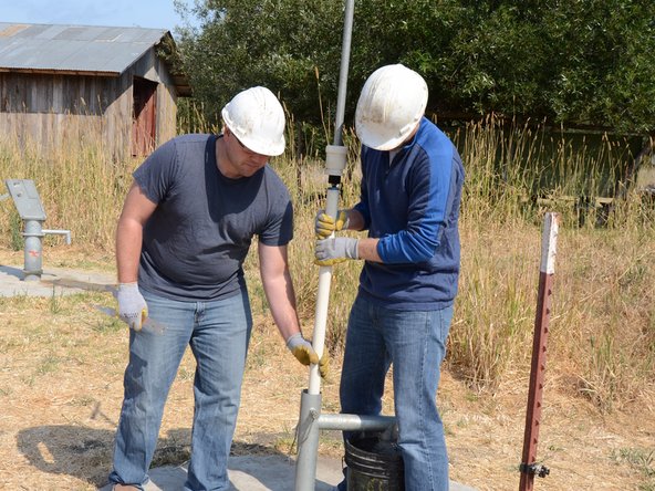

    • Screw the T-handle onto the top of the riser main.
  9. Tara Foot Valve Replacement: crwdns2935265:09crwdnd2935265:01crwdnd2935265:02crwdne2935265:0 Tara Foot Valve Replacement: crwdns2935265:09crwdnd2935265:02crwdnd2935265:02crwdne2935265:0
    • Tighten the jam nut up against the base of the T-handle.
  10. Tara Foot Valve Replacement: crwdns2935265:010crwdnd2935265:01crwdnd2935265:03crwdne2935265:0 Tara Foot Valve Replacement: crwdns2935265:010crwdnd2935265:02crwdnd2935265:03crwdne2935265:0 Tara Foot Valve Replacement: crwdns2935265:010crwdnd2935265:03crwdnd2935265:03crwdne2935265:0

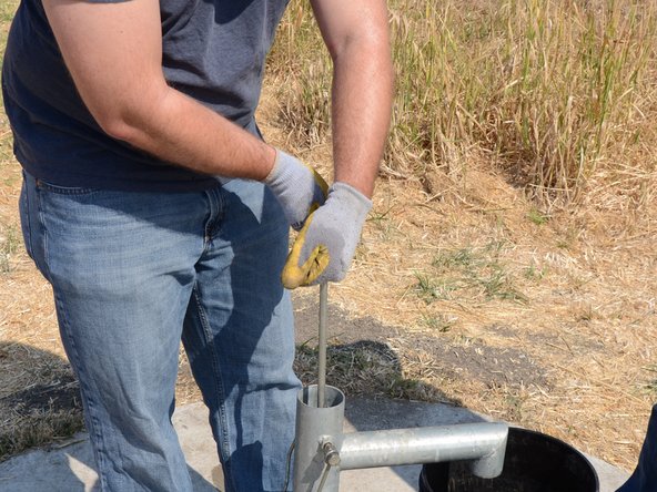

    • Use the T-handle to push the riser main back down into the well.
  11. Tara Foot Valve Replacement: crwdns2935265:011crwdnd2935265:01crwdnd2935265:03crwdne2935265:0 Tara Foot Valve Replacement: crwdns2935265:011crwdnd2935265:02crwdnd2935265:03crwdne2935265:0 Tara Foot Valve Replacement: crwdns2935265:011crwdnd2935265:03crwdnd2935265:03crwdne2935265:0
    • Once the riser main hits the bottom, turn the T-handle while pushing down.
    • This will hook the foot valve onto the traveling valve, allowing you to pull the two out of the well together.
    • You should feel some resistance if the foot valve is successfully attached.

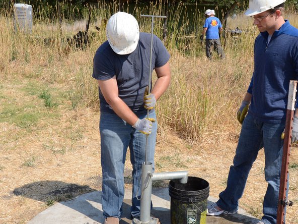

  12. Tara Foot Valve Replacement: crwdns2935265:012crwdnd2935265:01crwdnd2935265:02crwdne2935265:0 Tara Foot Valve Replacement: crwdns2935265:012crwdnd2935265:02crwdnd2935265:02crwdne2935265:0
    • Use the T-handle to pull the riser main straight up out of the well.
    • Take care to pull up slowly to ensure the foot valve does not get released from the hook at the end of the riser main.

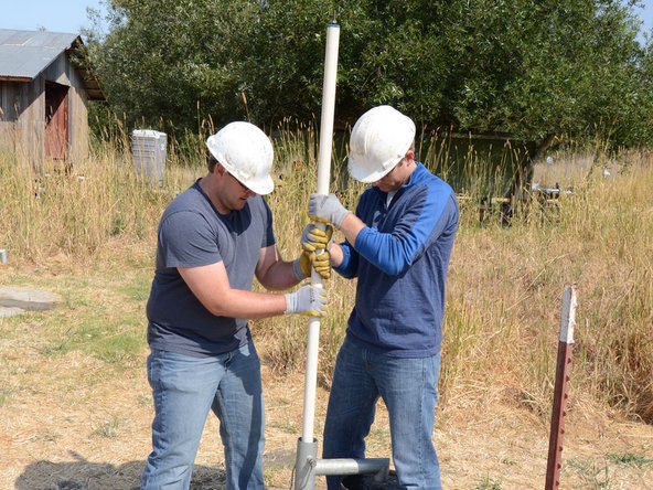

  13. Tara Foot Valve Replacement: crwdns2935265:013crwdnd2935265:01crwdnd2935265:02crwdne2935265:0 Tara Foot Valve Replacement: crwdns2935265:013crwdnd2935265:02crwdnd2935265:02crwdne2935265:0
    • Continue pulling the riser main up from the well.
    • Pull the riser main until the base of the T-handle is at a comfortable height to work on.
  14. Tara Foot Valve Replacement: crwdns2935265:014crwdnd2935265:01crwdnd2935265:03crwdne2935265:0 Tara Foot Valve Replacement: crwdns2935265:014crwdnd2935265:02crwdnd2935265:03crwdne2935265:0 Tara Foot Valve Replacement: crwdns2935265:014crwdnd2935265:03crwdnd2935265:03crwdne2935265:0

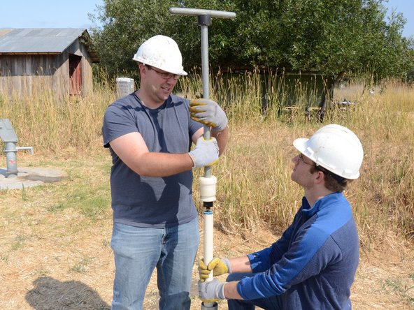

    • Remove the T-handle, making sure to hold the remaining end of the riser main to prevent dropping it down the well.

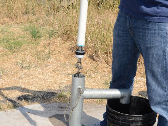

  15. Tara Foot Valve Replacement: crwdns2935265:015crwdnd2935265:01crwdnd2935265:03crwdne2935265:0 Tara Foot Valve Replacement: crwdns2935265:015crwdnd2935265:02crwdnd2935265:03crwdne2935265:0 Tara Foot Valve Replacement: crwdns2935265:015crwdnd2935265:03crwdnd2935265:03crwdne2935265:0

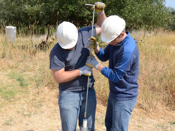

    • Continue to pull the riser main out of the well.

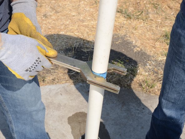

  16. Tara Foot Valve Replacement: crwdns2935265:016crwdnd2935265:01crwdnd2935265:03crwdne2935265:0 Tara Foot Valve Replacement: crwdns2935265:016crwdnd2935265:02crwdnd2935265:03crwdne2935265:0 Tara Foot Valve Replacement: crwdns2935265:016crwdnd2935265:03crwdnd2935265:03crwdne2935265:0
    • Keep pulling until the first joint is exposed.
    • Lift the joint up to a comfortable working height.
  17. Tara Foot Valve Replacement: crwdns2935265:017crwdnd2935265:01crwdnd2935265:03crwdne2935265:0 Tara Foot Valve Replacement: crwdns2935265:017crwdnd2935265:02crwdnd2935265:03crwdne2935265:0 Tara Foot Valve Replacement: crwdns2935265:017crwdnd2935265:03crwdnd2935265:03crwdne2935265:0

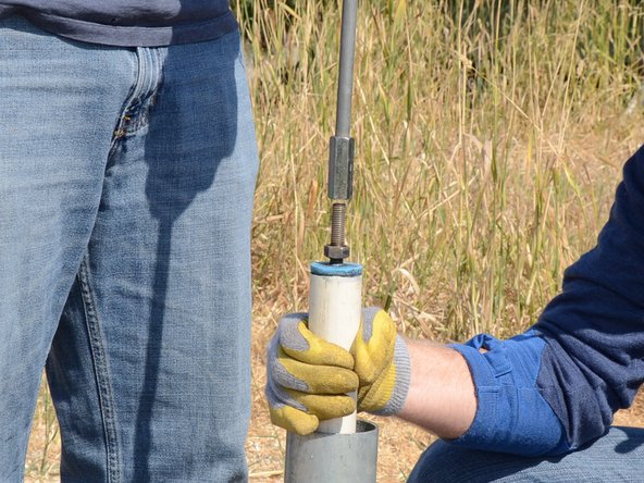

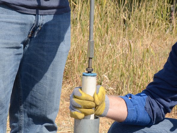

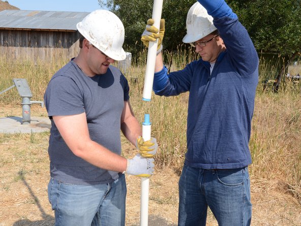

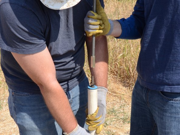

    • Use two wrenches to loosen the top section of riser main from the lower section.
    • Unscrew the top section of the riser main.
    • Make sure someone is holding the remaining section of the riser main.

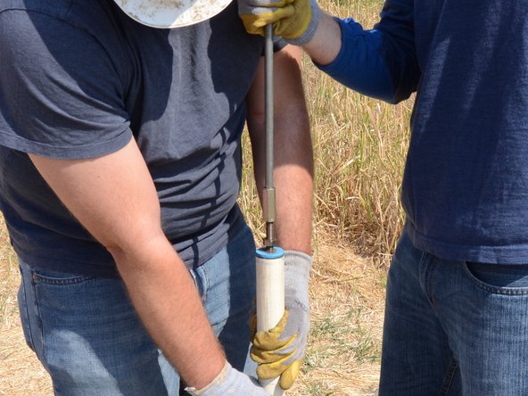

  18. Tara Foot Valve Replacement: crwdns2935265:018crwdnd2935265:01crwdnd2935265:03crwdne2935265:0 Tara Foot Valve Replacement: crwdns2935265:018crwdnd2935265:02crwdnd2935265:03crwdne2935265:0 Tara Foot Valve Replacement: crwdns2935265:018crwdnd2935265:03crwdnd2935265:03crwdne2935265:0
    • Remove the top section of the riser main.

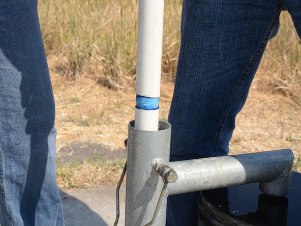

  19. Tara Foot Valve Replacement: crwdns2935265:019crwdnd2935265:01crwdnd2935265:01crwdne2935265:0
    • Lay the first section of riser main in a sanitary place to prevent contamination.
    • Repeat the previous procedure to remove the remaining sections of the riser main from the well.
    • Lay each new piece in the order it was removed to aid in reassembly.

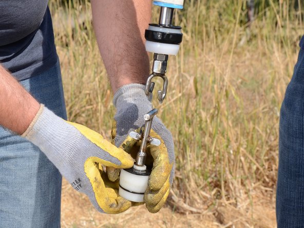

  20. Tara Foot Valve Replacement: crwdns2935265:020crwdnd2935265:01crwdnd2935265:03crwdne2935265:0 Tara Foot Valve Replacement: crwdns2935265:020crwdnd2935265:02crwdnd2935265:03crwdne2935265:0 Tara Foot Valve Replacement: crwdns2935265:020crwdnd2935265:03crwdnd2935265:03crwdne2935265:0

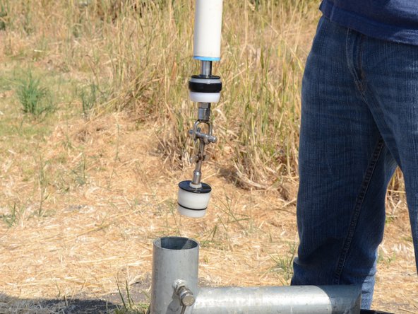

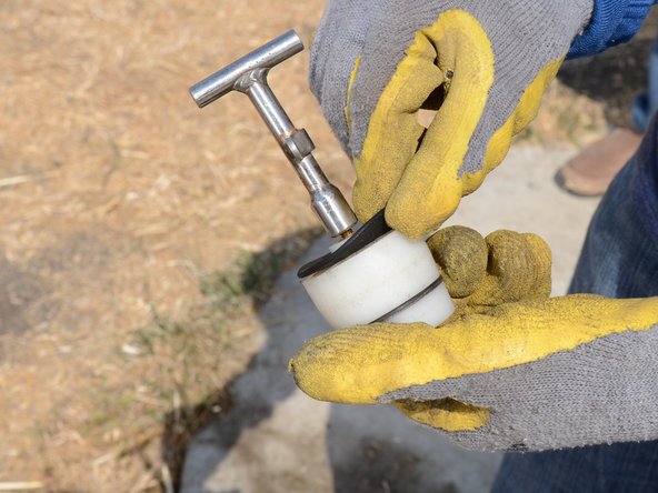

    • The last section of riser main will have the traveling valve screwed on to the end, and the foot valve hooked onto the traveling valve.
    • Be careful not to allow the foot valve to release from the hook by pulling slowly on the riser main.

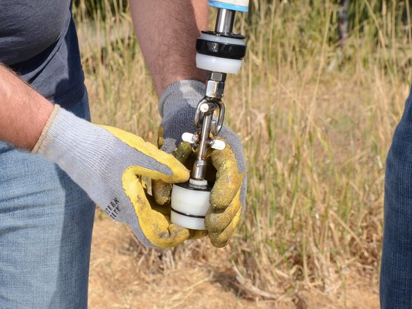

  21. Tara Foot Valve Replacement: crwdns2935265:021crwdnd2935265:01crwdnd2935265:03crwdne2935265:0 Tara Foot Valve Replacement: crwdns2935265:021crwdnd2935265:02crwdnd2935265:03crwdne2935265:0 Tara Foot Valve Replacement: crwdns2935265:021crwdnd2935265:03crwdnd2935265:03crwdne2935265:0

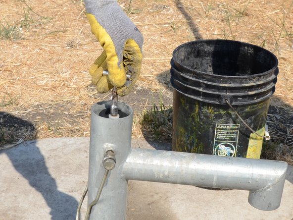

    • Lift and twist the foot valve to unhook it from the traveling valve.
  22. Tara Foot Valve Replacement: crwdns2935265:022crwdnd2935265:01crwdnd2935265:01crwdne2935265:0
    • Once the riser main and valves have been removed from the well, place a rag over the top to prevent accidentally dropping anything down the well.

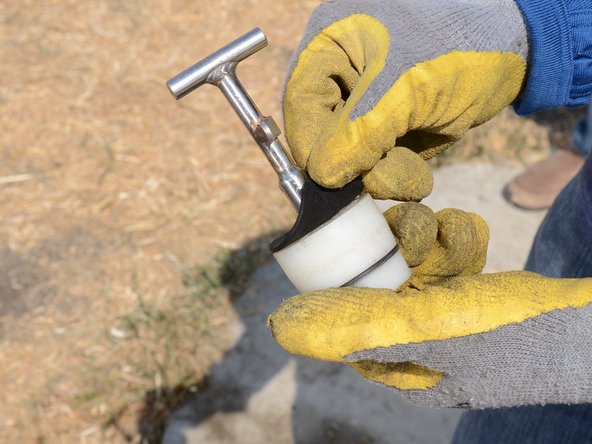

  23. Tara Foot Valve Replacement, Foot Valve: crwdns2935265:023crwdnd2935265:01crwdnd2935265:03crwdne2935265:0 Tara Foot Valve Replacement, Foot Valve: crwdns2935265:023crwdnd2935265:02crwdnd2935265:03crwdne2935265:0 Tara Foot Valve Replacement, Foot Valve: crwdns2935265:023crwdnd2935265:03crwdnd2935265:03crwdne2935265:0
    • Inspect the foot valve for signs of wear or damage.
  24. Tara Foot Valve Replacement: crwdns2935265:024crwdnd2935265:01crwdnd2935265:03crwdne2935265:0 Tara Foot Valve Replacement: crwdns2935265:024crwdnd2935265:02crwdnd2935265:03crwdne2935265:0 Tara Foot Valve Replacement: crwdns2935265:024crwdnd2935265:03crwdnd2935265:03crwdne2935265:0
