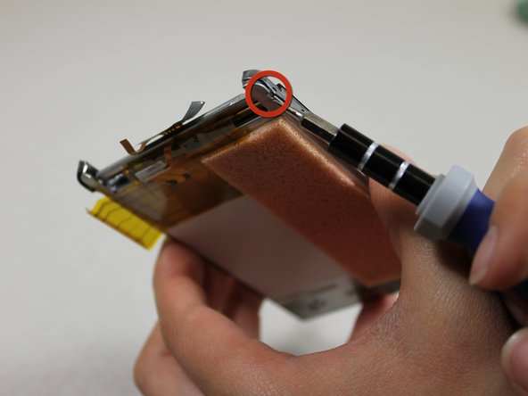

    1. Tapwave T2907US Zodiac 2 Touchscreen/Display Replacement, Touchscreen/Display: crwdns2935265:012crwdnd2935265:01crwdnd2935265:01crwdne2935265:0
      • Unscrew the 2 Philips #00 screws from the bottom edge of the screen component.
    2. Tapwave T2907US Zodiac 2 Touchscreen/Display Replacement: crwdns2935265:013crwdnd2935265:01crwdnd2935265:01crwdne2935265:0
      • Take off the brown wire-tape from the small circuit board component.
      • Lift up so that the black plastic hinge piece swings open and the tape can be removed.

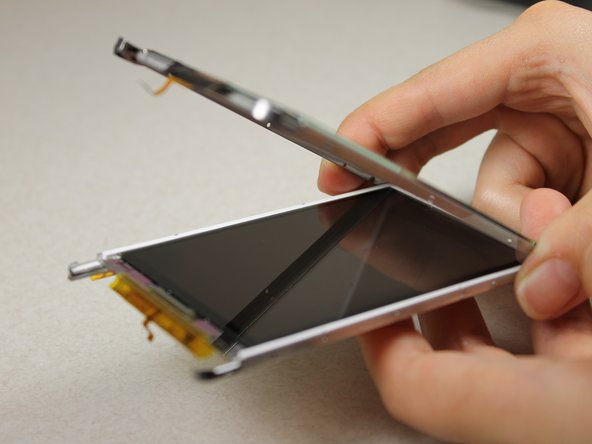

    3. Tapwave T2907US Zodiac 2 Touchscreen/Display Replacement: crwdns2935265:014crwdnd2935265:01crwdnd2935265:03crwdne2935265:0 Tapwave T2907US Zodiac 2 Touchscreen/Display Replacement: crwdns2935265:014crwdnd2935265:02crwdnd2935265:03crwdne2935265:0 Tapwave T2907US Zodiac 2 Touchscreen/Display Replacement: crwdns2935265:014crwdnd2935265:03crwdnd2935265:03crwdne2935265:0
      • Warning: If you are too rough with the screwdriver, you can permanently damage the display.
      • Use a Slot SL1.5 screwdriver to pry the touchscreen shell from the display component using the 4 slots around the entire component
