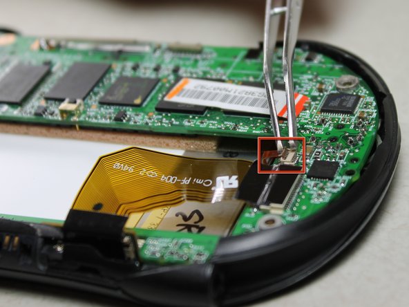

  8. Tapwave T2907US Zodiac 2 Directional Pad Replacement: crwdns2935265:08crwdnd2935265:01crwdnd2935265:02crwdne2935265:0 Tapwave T2907US Zodiac 2 Directional Pad Replacement: crwdns2935265:08crwdnd2935265:02crwdnd2935265:02crwdne2935265:0
    • Disconnect 2 brown wire-tape ends from each end of the motherboard. Gently pull straight out with tweezers.

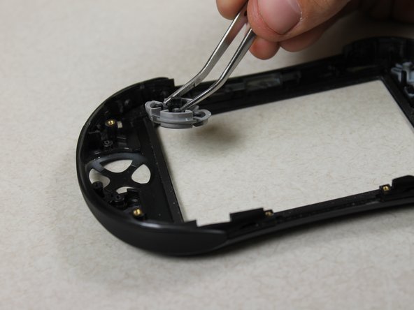

  10. Tapwave T2907US Zodiac 2 Directional Pad Replacement: crwdns2935265:010crwdnd2935265:01crwdnd2935265:01crwdne2935265:0
    • Unscrew the 2 silver Philips #00 screws from both sides of the directional pad component on the front casing.
  11. Tapwave T2907US Zodiac 2 Directional Pad Replacement: crwdns2935265:011crwdnd2935265:01crwdnd2935265:02crwdne2935265:0 Tapwave T2907US Zodiac 2 Directional Pad Replacement: crwdns2935265:011crwdnd2935265:02crwdnd2935265:02crwdne2935265:0
    • Take out the 2 pieces of the directional pad with tweezers.
